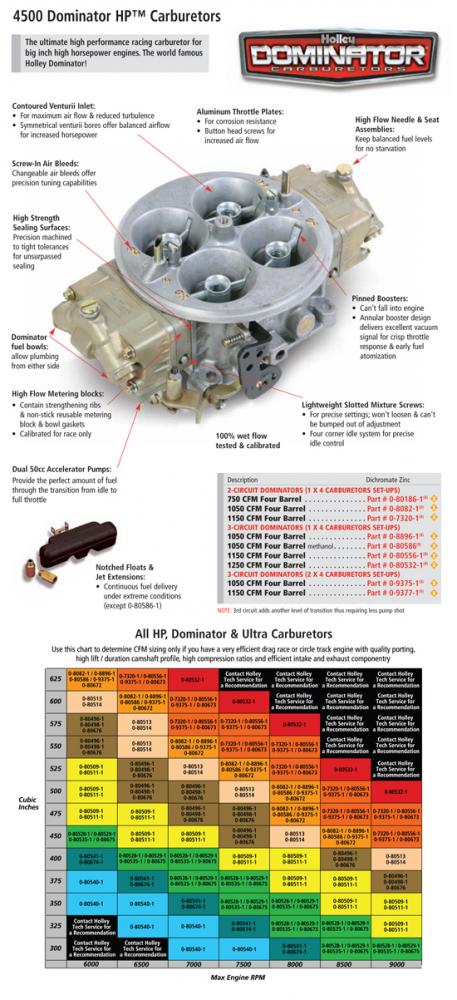

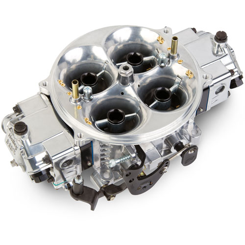

His car could use a 750cfm or maybe even a 1050 Domoinator, tuned properly !!, flow is flow, I've used them on quite a few combos people wouldn't think, it will work great on... His car is capable of 11.50's, if he sheds some weight maybe faster & gets it tuned properly & the converter in finally...
budnicks, he's only going 12.2's at best.
dominator carb??????? :drowning:
It's capable of allot better, it isn't there yet... he's got plenty of engine... they do make the Dominator Gen 3 in both a 750cfm & 950cfm IIRC too...
depends on well his heads were done/flowed, flow is flow, I've ran a Dominator 1050 on a smaller engine with less cam & mildly ported RPM heads & went 9.70's 9.90's easily in a 3250# RR, they are great tunable carbs... if he has enough cam now for the new {SSR} converter, not run out of motor, quit pulling @ 1/2 track, it could work with the, cold air scoop, isulated fuel, correc6t spacer, the right air bleeds, jets, pumps, squiters & cams, metering blocks, manifold & fuel system &/or open exhaust "race headers" with the correct extensions etc.
