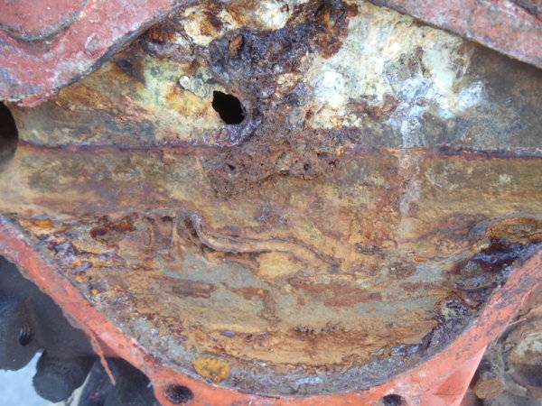

In the timing cover, directly behind the water pump, I found a hole corroded right thru my aluminum timing cover. A perforation in this area will allow coolant to mix with oil in the crankcase. Just a thought.

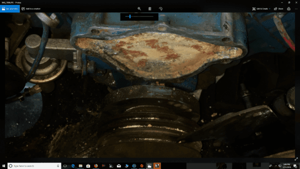

Wow good point! I did clean this off so far this is the best pic before cleaning. I did not see any obvious holes. I might pull that area appart and check again!

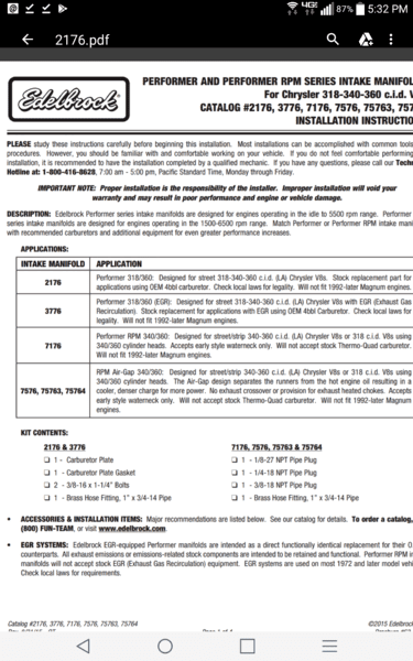

I have looked hard, and it is real odd. Water in all cylinders?!?!? The heads are LA heads, and the manifold looks to fit the LA properly. Also, a hole in the timing cover will put water in the crankcase, and not into the cylinders. I see the cork end pieces, but that would only send water into the crankcase, not the cylinders. There is also no way I can see any water getting into ALL cylinders, if any at all. It does look like you used silicone on the end rails on the new manifold, so that again when you put it back. The cork will usually hold up the manifold, and water leaks into the crankcase. The only thing I can imagine is that maybe the heads were not tight. Taking off heads can get water in cylinders, but certainly NOT all of them, and sure as hell not that much water. How hard was it to remove the head bolts?
