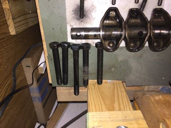

Humm, those head bolts were quite tough to un torque! Maybe they were rusted in? I will take a close look at them.

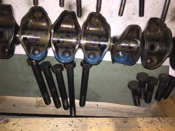

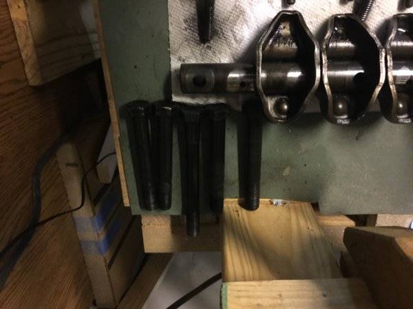

Bolts one looks suspect in the middle rest look ok hmmmm....

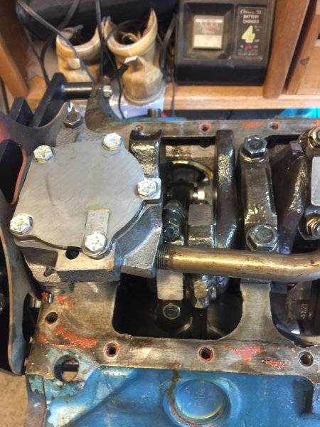

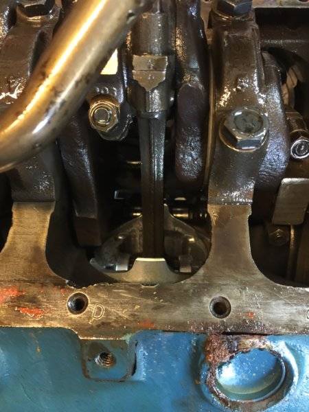

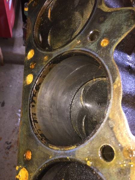

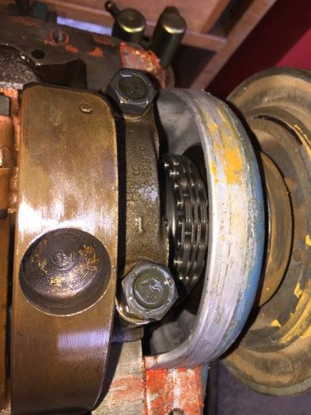

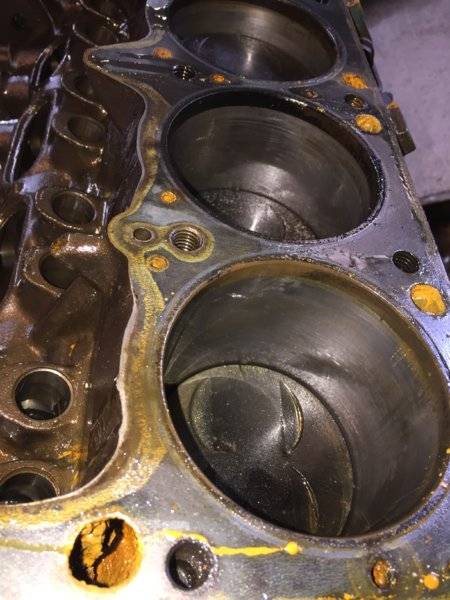

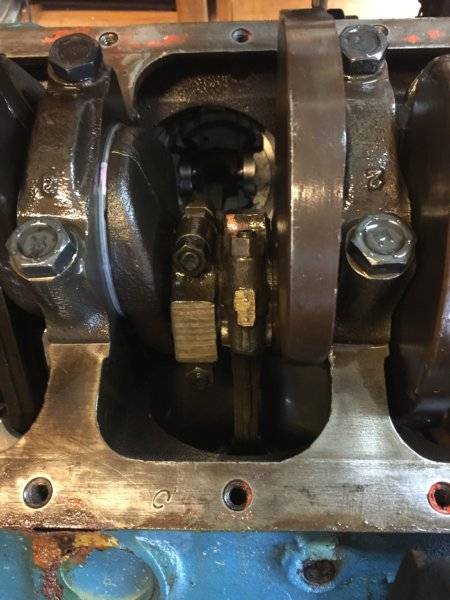

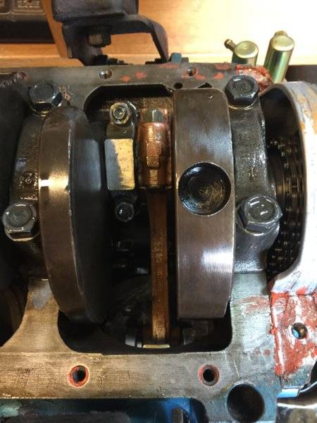

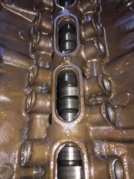

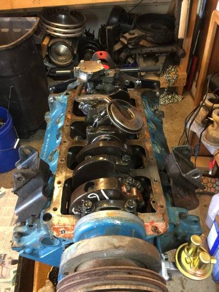

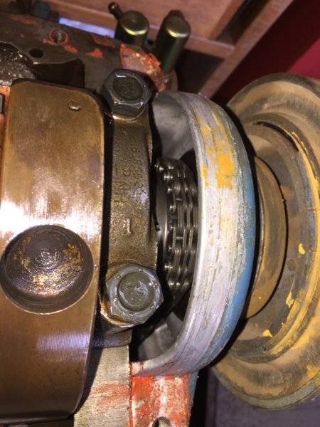

So here are some pictures og the engine after being pulled. I can’t see anything suspicious other than the gaskets which I am not sure was caused by my dissassembly of the heads from the block. I wonder what the formal teardown and reassembly process would cost at a shop? Looks like the engine was rebuilt?
7B18A90C-DA3D-40AD-A511-A0AC1483900A.jpeg C4C8219D-8449-4719-B7AE-5A91B9BD006C.jpeg
Your freeze plugs are shot.
Just wondering if a corrosion buildup pushed up the intake a tad and started the water leak?Just an idea from freeze plug pic. It is a SB right?
Yes its a 318, the intake gaskets looked good.
Looks like it was apart before with the orange silicon. I tore mine all the way down and had Dave put it back together. I could not justify doing it twice if I did it for what he charged to reassemble it to a long block.
Well it doesn’t take much to push out a gasket, just throwing out ideas. OR eating out some metal(?)
