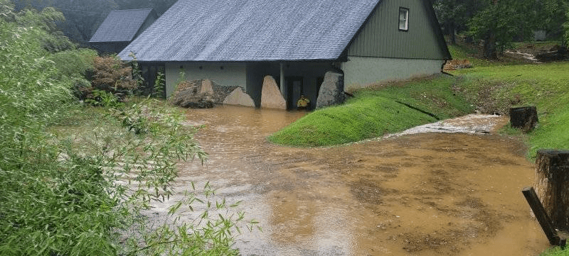

got hit with 4+ inches of rain in less than an hour sunday afternoon, caused a flash flood, my charger was on the ground, thankfully, the satty was on the lift.. waiting on insurance adjuster now, charger had water up past the seats.
only the garage and man cave flooded

I THOUGHT we are in good place, half way down a holler., problem was way too much rain in a short period. drainage just could not keep up. it just happened soooo fast
I called Serve Pro and had them out here that night , 4 big dehumidifiers set up, cut out all the lower drywall and removed insulation the next morning.
other than the charger, most wont be too bad.
trying to work with state/county to improve drainage issues

LOL, it isnt really, there is a small creek that runs through my property, but is always 6-8 feet below the foundation level of the garage

May I offer the following: From the looks of this photo the drain at the end of the swale was either too small or blocked by debris. I would consider removing the pipe and recreating the swale to the stream beyond. From the looks of the other photos there is a lot of area draining to this low point.
Sorry to hear about the flood. Good luck with the clean up.
yes you are correct, there is a drain pipe that runs UNDER both properties to my right ( down hill side ) . have calls into state to see if the can help, never had a problem with volume, the 3rd property to my right is where the drain pipe exits, how ever, it was abandoned several years ago and the creek path is very over grown, i think this caused a back up / slow flow in the pipe with debris being caught as soon as the water exited the pipe.
just below the closest stump to the right in pic the is a 24 inch drain pipe about 9 feet down, so the water there is 9 foot deep in this picture
