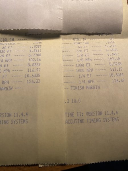

Well a little update. I got my 9in convertor back from PTC yesterday. I have to say great people to deal with (PTC) super nice and fast service. Sonny said my stall should be 5,000 but slip less down track. Installed Wilwood rear discs. Took off 11 in drums and exhaust and lost 74Lbs. I have new aluminum M/C coming along with new lighter front runners. Track opens the end of April can't wait
Made it out Friday.the weather was great! Had 9in converter in single 4bl Indy intake with a proform 1050 4150 style carb. Loss 101lbs over the winter. Took exhaust off, rear drums off disc brakes aluminum m/c and lighter front tires. Best pass was 10.60@126. I’m going to put crossram back on and see how much it slows down. The 60 foot was very inconsistent. I have to work on that.
Other than the1.53 outlier, the other three are within .015. Hardly wildly inconsistent.....
I'm guessing the quickest/fastest pass was the last one? (best air?).
I had 2 other runs that it spun 1.57 & 1.58 60 ft. Tried higher launch rom.
Congrats, on getting down in the mid 10.60's
weight off the nose will help, now too
scale the car, make sure its right
have you already moved the battery to the trunk ?
what ever weight you get off the nose
& put in the back is like double the effort
the thinner 0.027" Cometic head gaskets @malex mentioned
is a great idea too, bump that compression up a lil'
try & get a gasket with 'a bore diameter' closer to your actual diameter too
without getting into the combustion chambers
just some sweat equity & $200
Maybe a 1.6:1 rocker change (10% more lift across the board)
if you have the 'Valve to piston clearances' too
while its off (the heads) measure how far down in hole the pistons are,
(maybe shave a lil' off the heads too, if need be)
you can figure out the quench (you want in the neighborhood of 0.030"-0.040")
& what compression (& sized valve reliefs) you have that way too
sometime a lil' notch/valve sized bevel on the sides where the intake valve is
(you can sometimes use the gaskets as a guide, to not exceed or ask a machinist for tech)
on the outside of the bore, the intake valves side of the top of the cylinders,
helps valve/air cfm flow,
if it has big valves it can be shrouding the valves 'hampering potential HP' too
albeit the org. stock max-wedge cross-rams 'look cool' (awesome even)
but they rob a lot of power, potential...
I knew a couple guys, that went in the 9.70s with them, back in the 80s
in 3,500# cars with S/S springs 29x10" slicks & slant 6 torsion bars,
Rancho single adj. shocks
fiberglass hood & scoop sealed off to the carbs
fiberglass front bumpers & alum. bumper brackets
the manifold were extensively worked, a bunch of lil' tricks, they held closely secret
& they ran Holleys 660's (flowed like 725cfm ea.)
on 1/2" 4 port tapered phenolic spacers IIRC
'carbs jetted & set up for their combo'
the 2 Edelbrocks #1407 IIRC (AFB style) 750cfm, no matter what they tried
held them back especially in the 60ft time...
can you run a Trans-brake in your class ?
that will help a tone with converter stall & not pushing thru the front braks
keep chipping at it, you're going in the right direction
funny I never saw this thread before today
good luck
