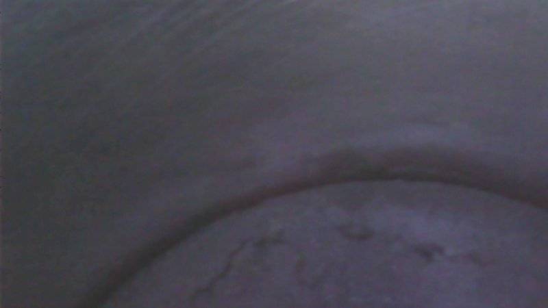

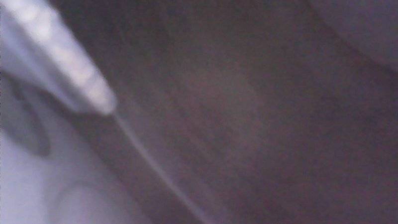

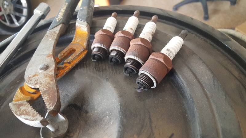

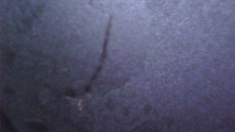

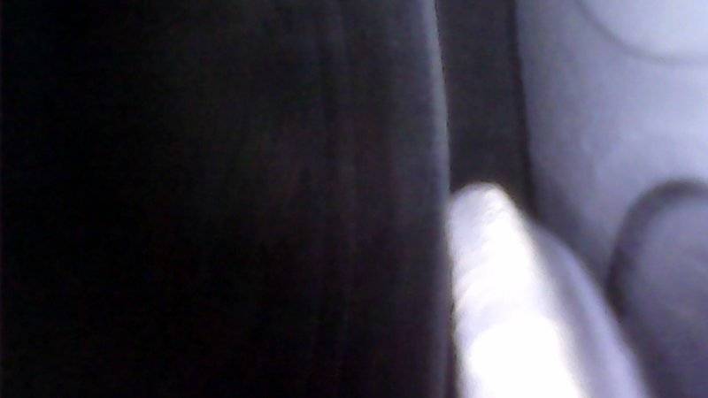

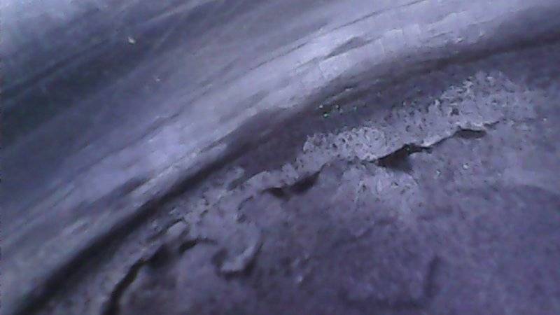

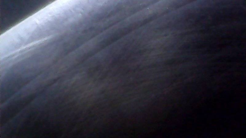

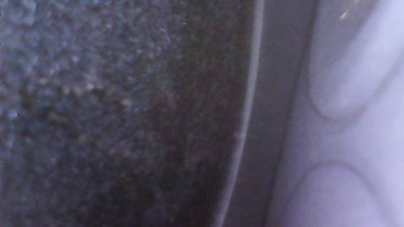

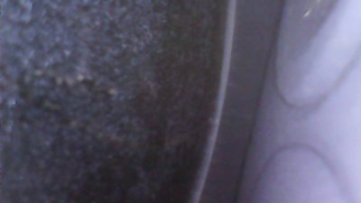

Pulled the plugs and put a camera in the holes. Can see cross hatch, some of the valves, and carbon on top of the pistons. Some pistons had little to no carbon, some had more, the pics show the worst ones. How does it look?
