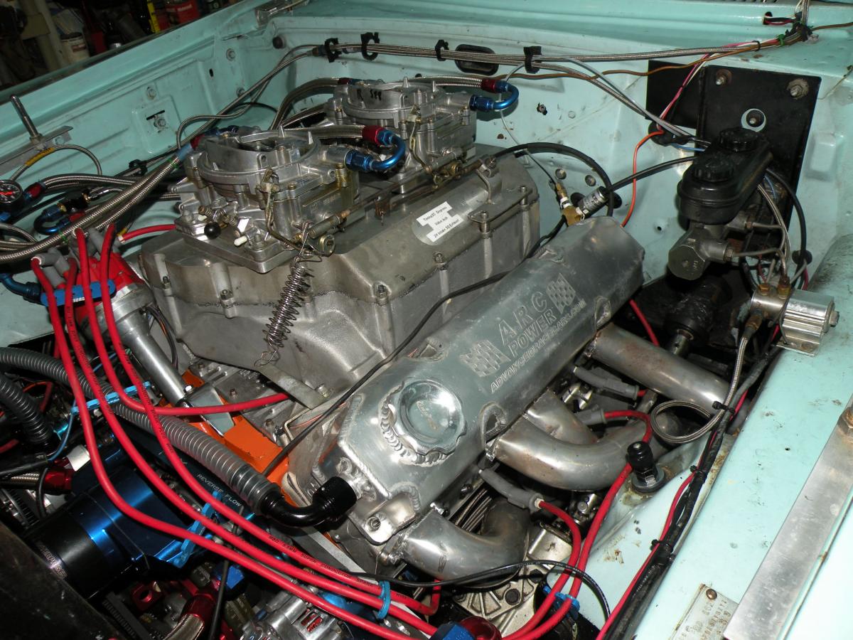

if tyou go with an edelbrock get the 800 series performer. i like them the best for my race car but i run 2 of them.
