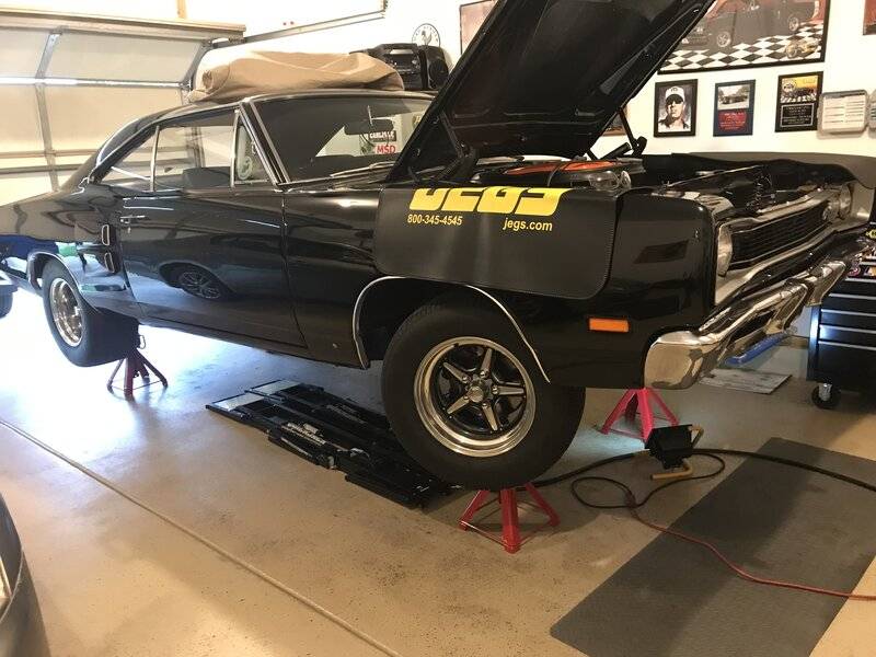

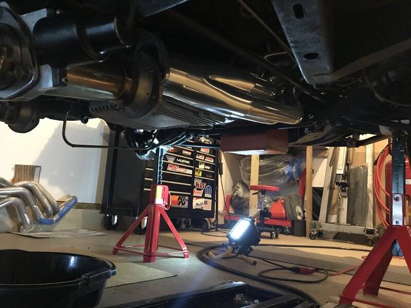

The Bee is up in the air, and dropping the trans/Gearvendor tonight. Though I still need to run out and buy another jack for tonight, one jack to support the motor, and one to lower the transmission. Also needed higher jack stands, so I searched the posts here, and picked up 2 sets of the US Jack 6-ton stands and being very close to Benton Harbor, MI, the jack stands were here in a day. As someone said in one of the posts, "how valuable is your life?" There's always a part of me that is hesitant getting under a car even with the wheels on.

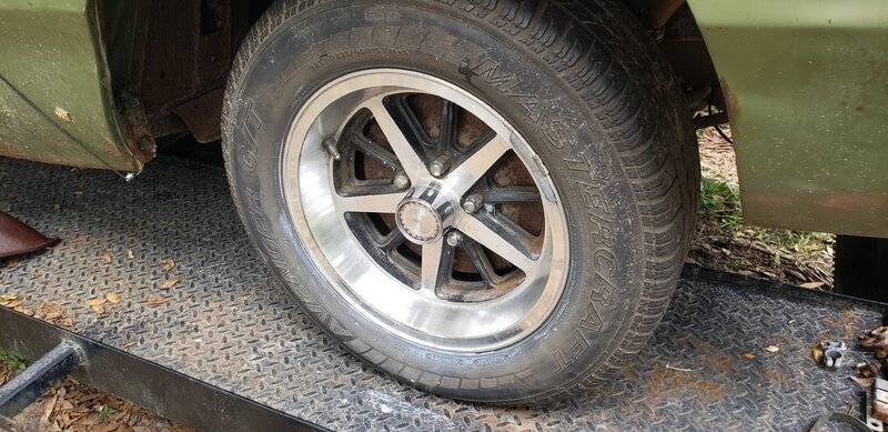

What style of wheels are those, they look sharp.
Billet Specialties 5 spoke with black highlights. The back wheels are 10" with 295 tires on them. I can pick the entire thing up with one arm. Nice and lightweight.

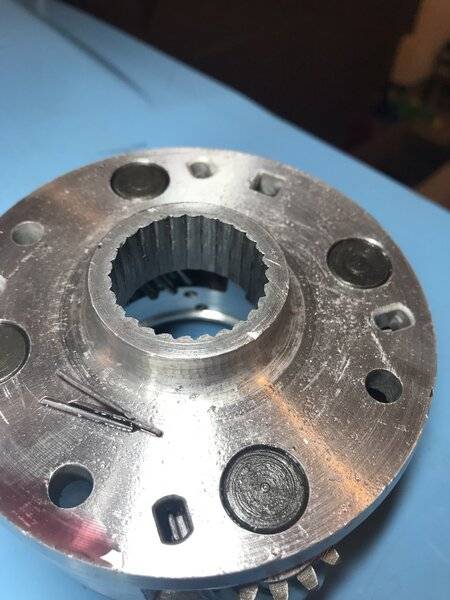

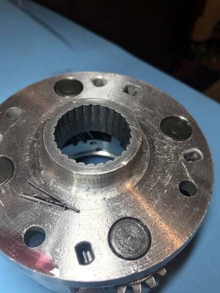

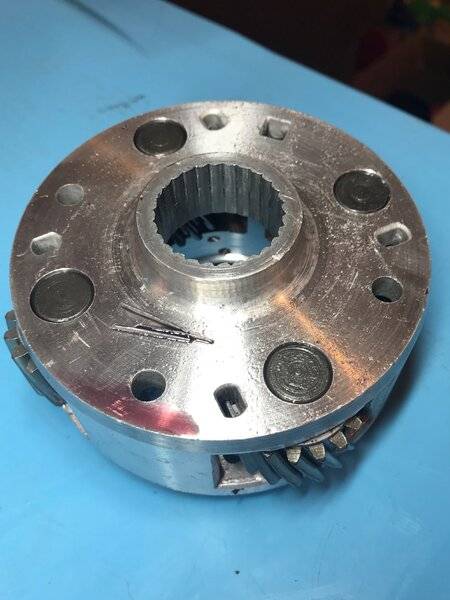

Picked up the "new" transmission and pieces last night from Keith. Almost everything inside was replaced, he has his way, and others have their ways. He used his valve body with his "tricks" versus working with someone else's. But here's pictures of the stripped front planetary pack with shrapnel shards still on it; didn't even know it was a 4 gear one.

That’s kind of discerning - how much hp is your engine making? I’ve always found these torqueflites to be really tough - I abused the one in my 64 Sport Fury as a kid for years - pulling full throttle auto downshifts to first at nearly 40 mph more times than I can count. But I guess the little old 383 Commando didn’t have enough guts for that kind of carnage. Good to see you got it all fixed up, better than before.
The Bee makes 600 at the crank. And curious if the 4:10 gear amplified things? But I learned my lesson, no more D to 1 downshifts when doing 40mph.
