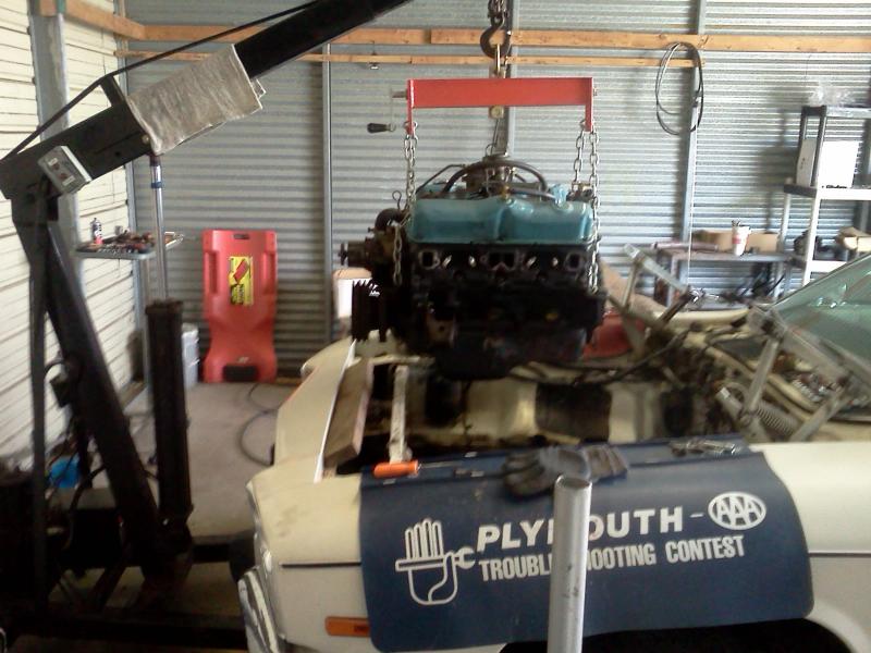

Well last night I loosened up roller rockers on number 1 to make sure they were closed so I could run another compression test on number 1 using the Katech whistler. The first time I tried it there was almost immediate leak down and machine registered hardly any compression. Thought due to excessive engine tightness, pistons too tight rings , lands messed up. After some research before pulling motor, I tried again.
Results this time: got it loosened up, ran test, got a good reading, 8:0. That was it. It would explain a ton. Low compression for sure.
Readjusted all rockers to make sure weren't too tight, tried a quick run and not much better. Time for the stroked 400!!! I have the block all ready!!
Thanks to FBBO member Digger1658! Top notch guy! THANKS!!
Got it out.

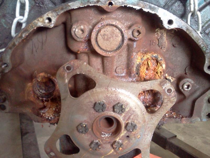

Found the problem.
Now the fun of cleaning and painting all this.

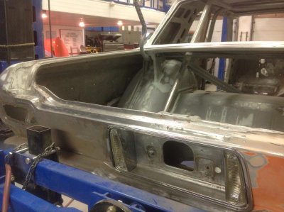

Today I cut out the spare tire well. I then sliced the sides of the well and flattened it. Trimmed the edges off and clamped the remains into place on the trunk floor. So, now it will have a semi flat floor with the stock spare tire mount flange in the center. Needs some more trimming and bending and cutting filler wedges to fill in the now flat curved pieces and weld her up.

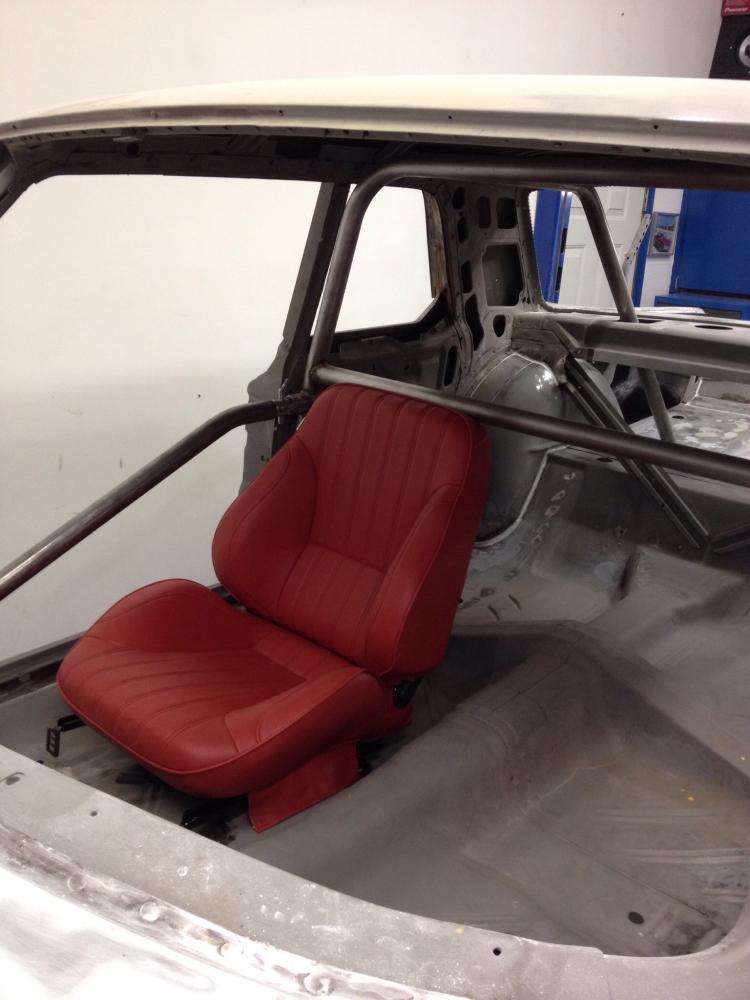

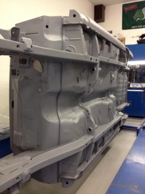

Positioned and mounted the front seats, fit the back-up lights and final seam sealing before priminng the chassis.image.jpgimage.jpg

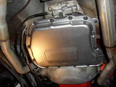

I've been wanting to change my 63 transmission strainer to a Dacron filter for some time now and finally got it done yesterday. Had been gathering the right parts, late model trans pan from Moparmarks and early model filter we found at a Dodge dealer in Duncannon Pa.(3621456)SAM_1362.jpg

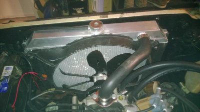

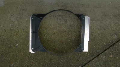

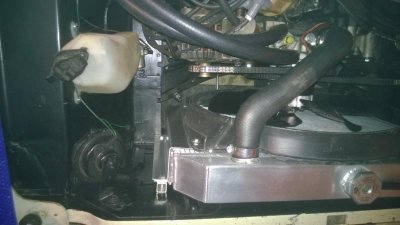

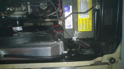

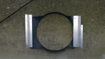

Finally got the fan shroud installed, along with new upper, lower rad hoses, both fan belts and new thermostat. Here's to hoping there are no leaks!WP_20150117_001.jpgWP_20150117_002.jpgWP_20150117_006.jpgWP_20150117_007.jpgWP_20150117_010.jpg

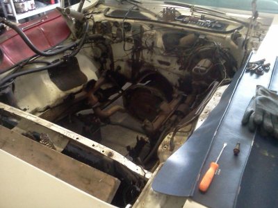

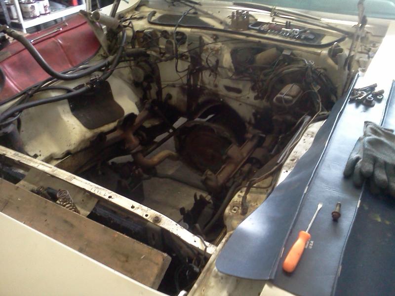

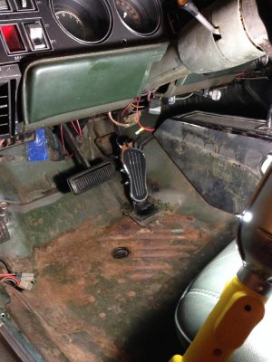

I decided to tackle the dash wiring harness today. We found a new M&H harness in a box in the trunk when the car was delivered. I've been a little leery of doing it but after reading multiple posts on the forum I just went at it. Fairly painless after all.
Taking steering column apart apart tomorrow to put the new turn signal switch in and putting the new steering wheel on it at the same time.
Didnt take any pics today but I will get some of the new harness tomorrow before stuff goes back together.
