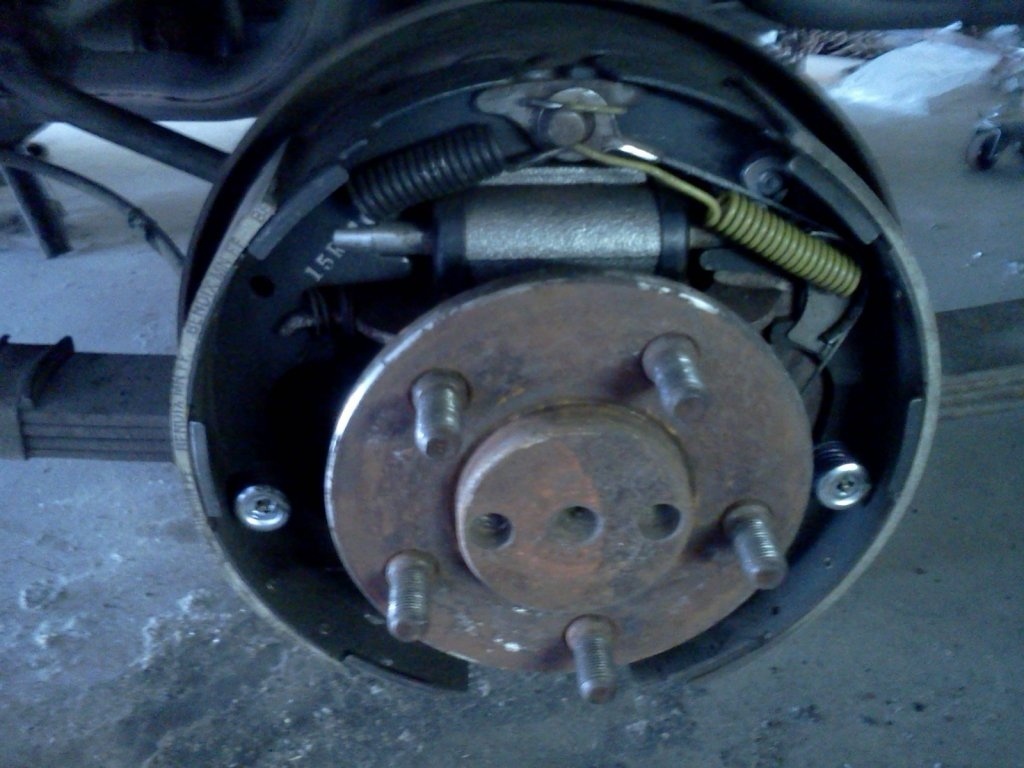

I got almost all of the brake system back together save the front calipers and soft lines.
Would have got them but decided on another coat of paint.
It's not quite as pretty as OEM, but it's close.

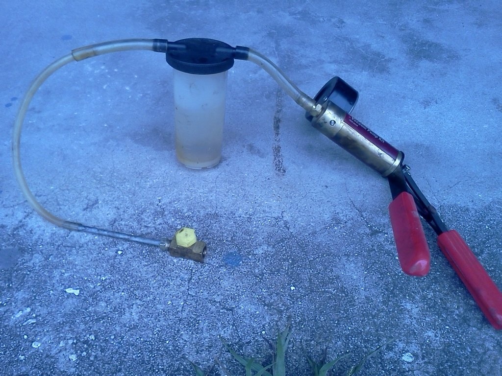

I made a tool to get brakeleen through the lines and vacuum out the residue.
I was not able to get the pass side line just like the factory, but I got it to where it doesn't rub and looks passable.
All in all I am pleased with the "Right Stuff" stainless line set, but just like their trans lines some bends are not quite factory, but appear to be concessions for ease of installation.
I also found that you can get the rear wheel cylinders out if you remove only the "easiest" spring (the one without the self adjuster) on each side and remove one of the actuator pins. That gives you just enough room to roll and wiggle the cylinder out and save quite a bit of time and potential frustration.

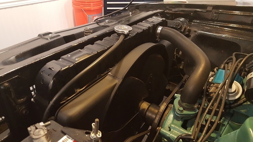

Installed my new fan shroud. Test run tomorrow to see if it solves my idling cooling issue. New radiator keeps it at 185-190 when I'm moving but still shoots up to 210 when sitting in traffic. Before the new radiator it would have a hard time getting back to 210 after sitting in traffic, where the new one gets it back to 185-190 as soon as I'm moving. Hoping the shroud keeps it lower while idling.
Nice, please let us know how it works out. I have a 65 Coronet without a fan shroud and what is probably the original radiator. It's not quite on the road yet, but I'm concerned about it keeping cool also.
