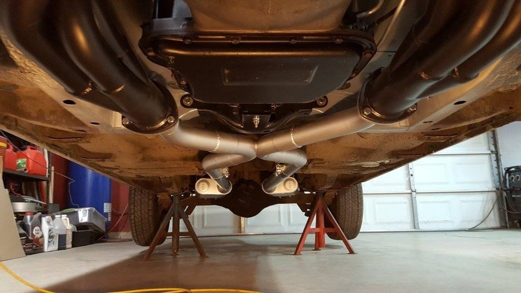

Tack welding collectors to H-pipe. Can't wait to get out from underneath to weld in more comfort.

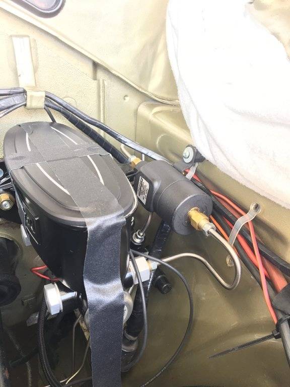

installed Moroso line lock. still gotta bleed, test, and burnout.

Finished welding collectors to h-pipe. Getting better at laying down a bead. Will remove H-pipe tomorrow. Will grind out ugly welds and redo them.
Welding under car for a rookie isn't fun but progress. Anybody have experience with band muffler clamps and how well do they seal?

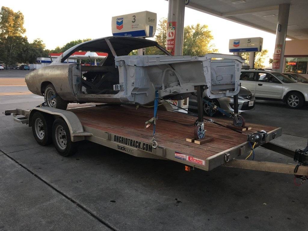

took sally to my buddys shop ...... and so it starts. ... won't see the sun till spring ..... with the original sunfire yellow paint.

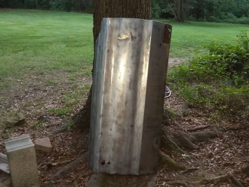

Stripped down the passenger door . . . got the body molding holes filled using my TIG ( turned out pretty good too )

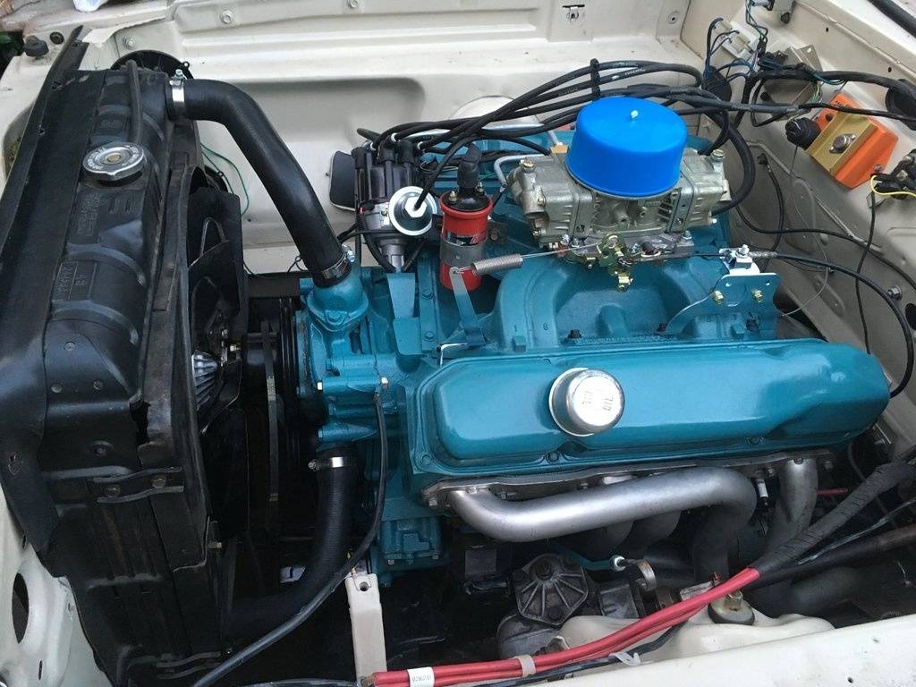

Took my new motor out for its first drive. It was hot out and the engine got a little warm quickly so it was a short drive. I gotta tell you though, I am loving the trick flow heads. I only tested it a little but my 440 pulls GOOD!

We use band type exhaust clamps almost exclusively on 18 wheelers. They work great. Where the ends bolt together, they use a strip of wadded up tin-foil............................MO
I used the stainless steel ones. Useing them after the X pipe for easy removal. Actually using them at a slip joint, two different diameters and the band formed to it great. Re tighten after a couple of heat cycles.

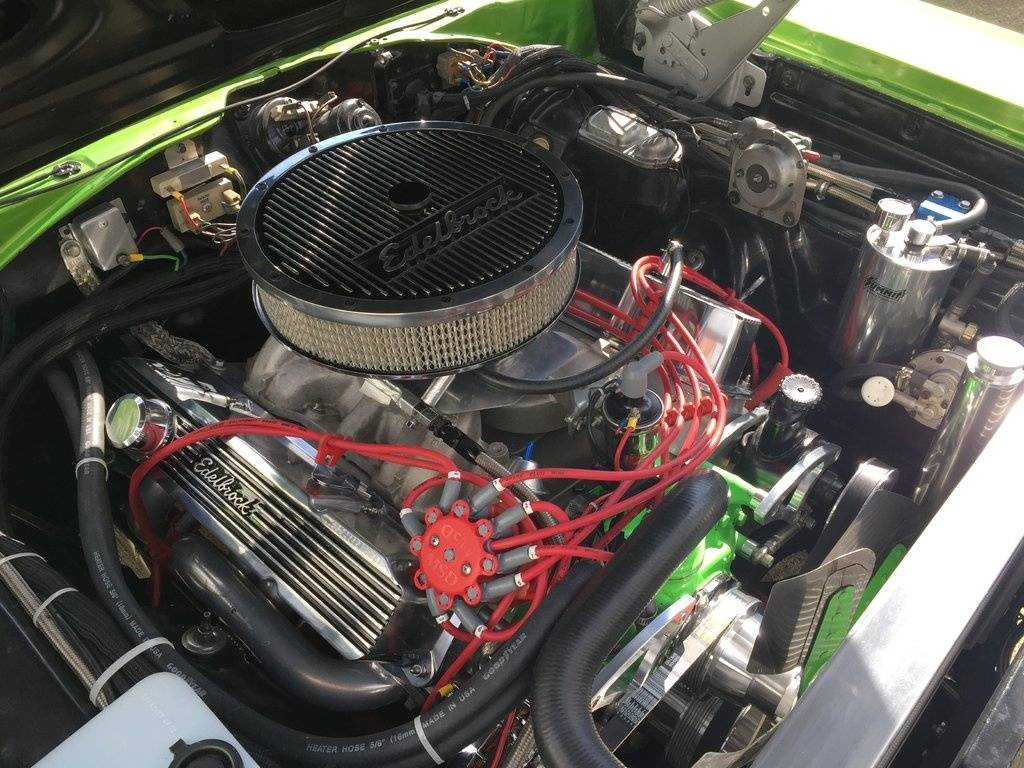

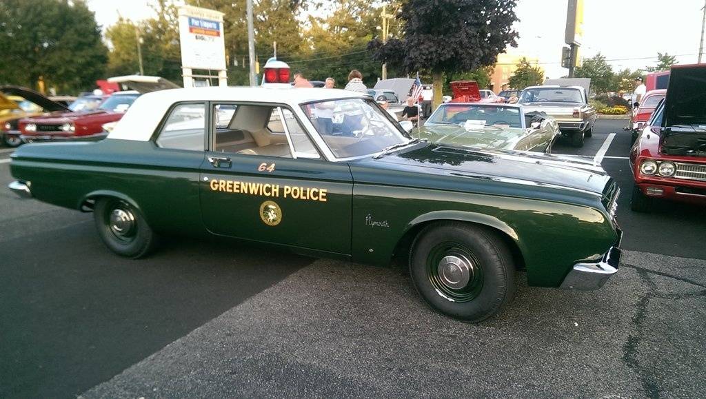

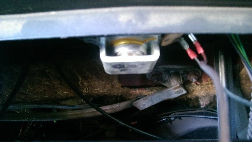

My 64 is resting...waiting for the air cleaners, from CrossramConnection. Already moved the VR.

Removed H-pipe today.

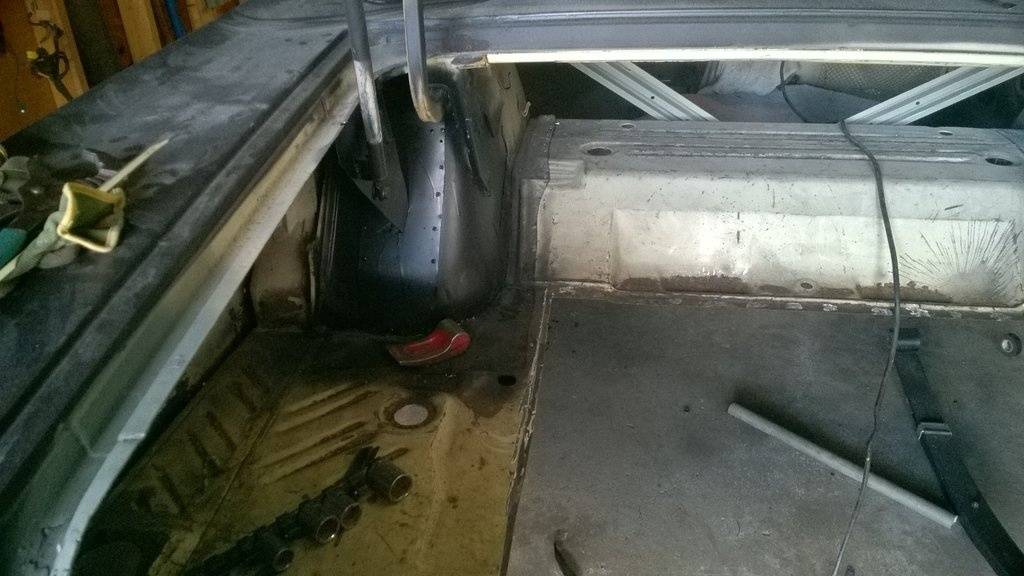

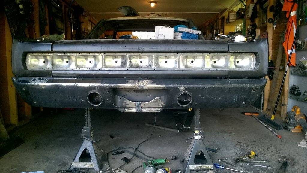

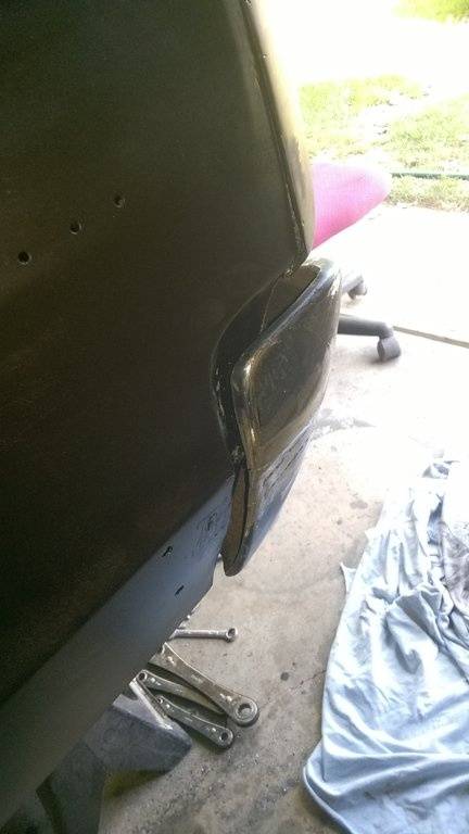

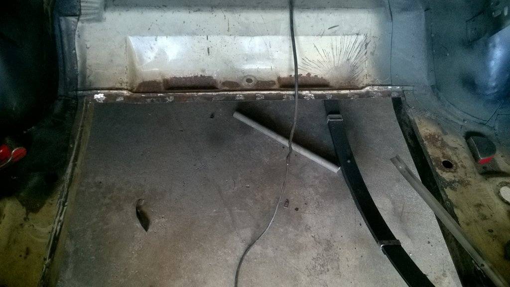

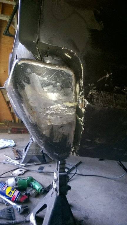

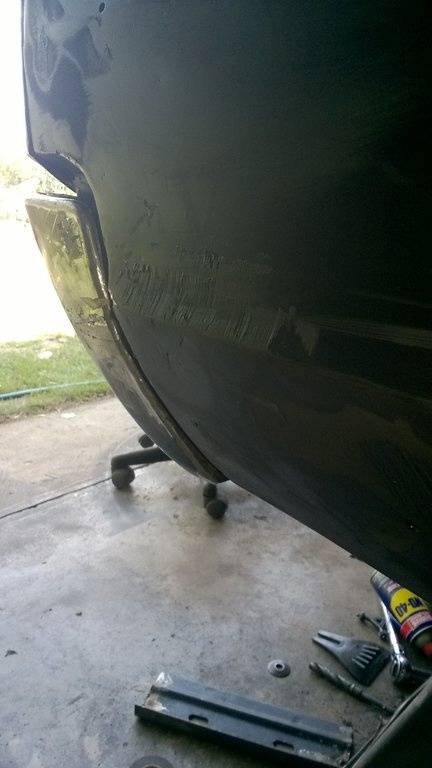

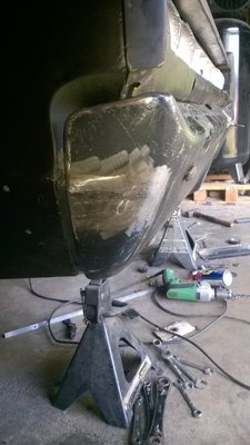

Modified the rear 1970 RR bumper brackets and face plates off of the rear of the Coronet. Had to raise the brackets up 2 inches and out 1 1/2 inches to the left and right because I added another 1 1/4" to the center of the bumper. Now the ends, after convincing them with a BFH, fold in to follow the quarter lines. Nice and flush. Had to redrill some of the bumper bolt mounting holes in the brackets to align with the new length. Also sliced the trunk floor pan along the center of the frame lip and across the front at the seam in order to place a new panel in there flush. Also finished the left side wheel tub.
