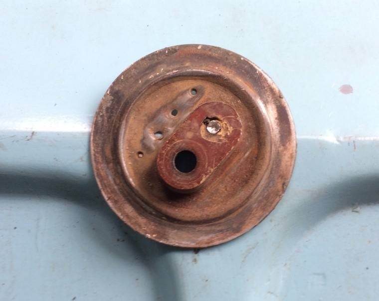

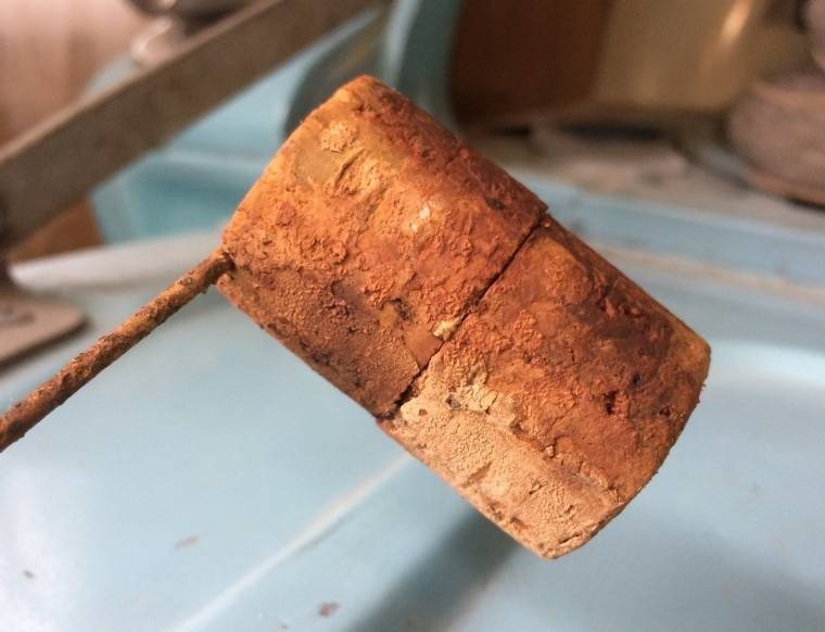

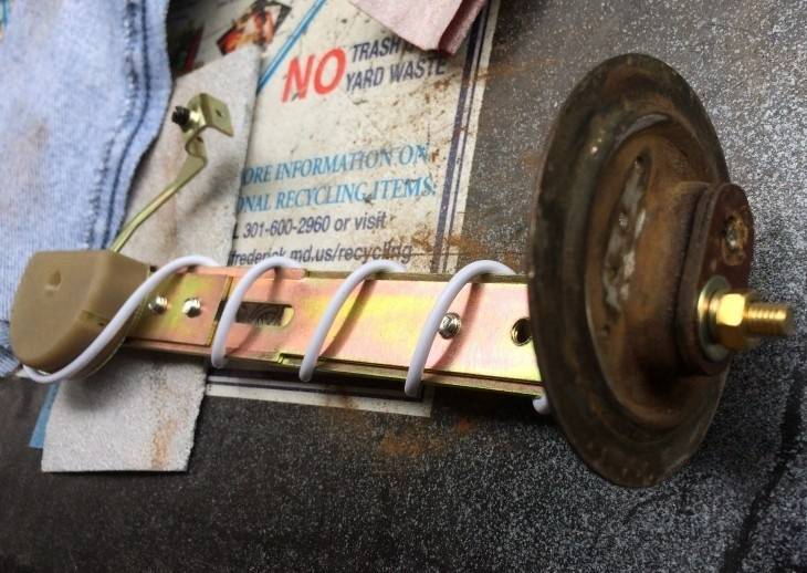

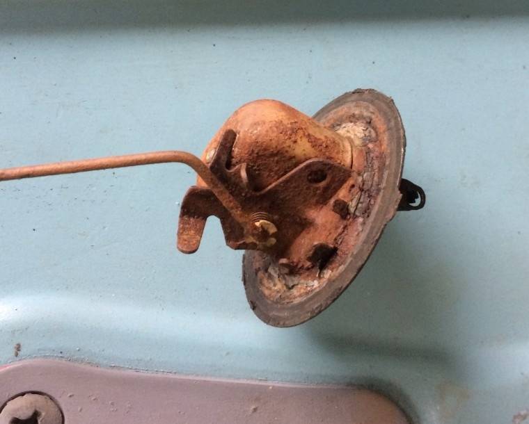

The gas gauge in the 1955 Plymouth isn't working. So, I pulled the sending unit and found the resistance was the same with the float up as with the float down. So, for the time being, I picked up an inexpensive gauge/sending unit and gauge pod to mount under the dash. I took the top off the OEM sender and took the aftermarket sender apart. I mounted the top of the OEM unit onto the aftermarket unit's guts.

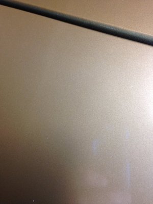

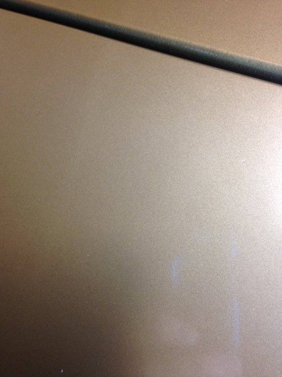

Learned some new detailing technics from another member who has been super generous and helpful with his time. Stay tuned for details and photos....

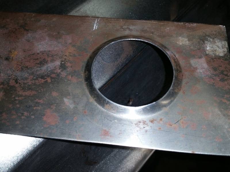

Finally busted out the dimple die set that I bought a while back to attempt to use it ( and see how it goes )
- Tested on a piece of scrap metal before moving to a test on the car . . . and here's the result . . .
Then I found a little area in the car that looked like a good candidate . . . and gave it a try there - here's the result . . .
Pretty happy with the results - and I've got a way to do it with relative "ease" . . .

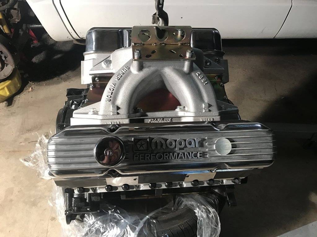

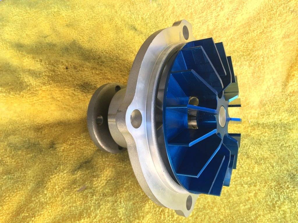

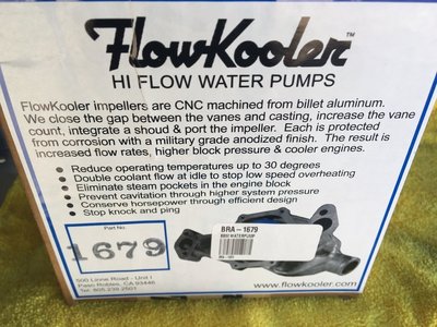

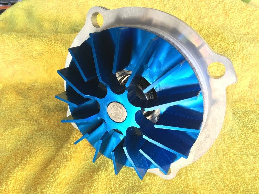

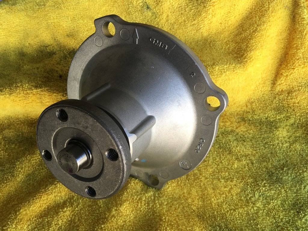

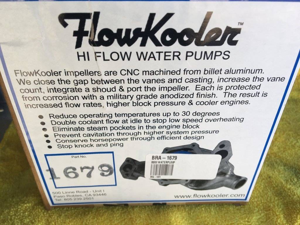

drained coolant some
getting ready for new thermostat and water pump install
got a Flowkooler for the 440ci

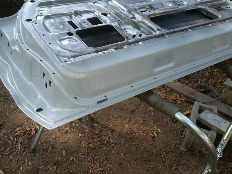

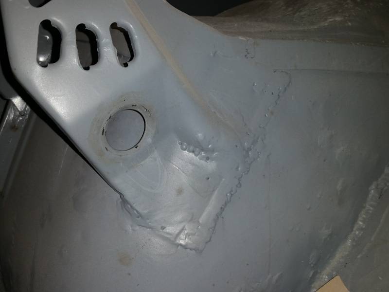

Getting some Epoxy Primer on the bare metal of my car parts that I've been working on lately . . .

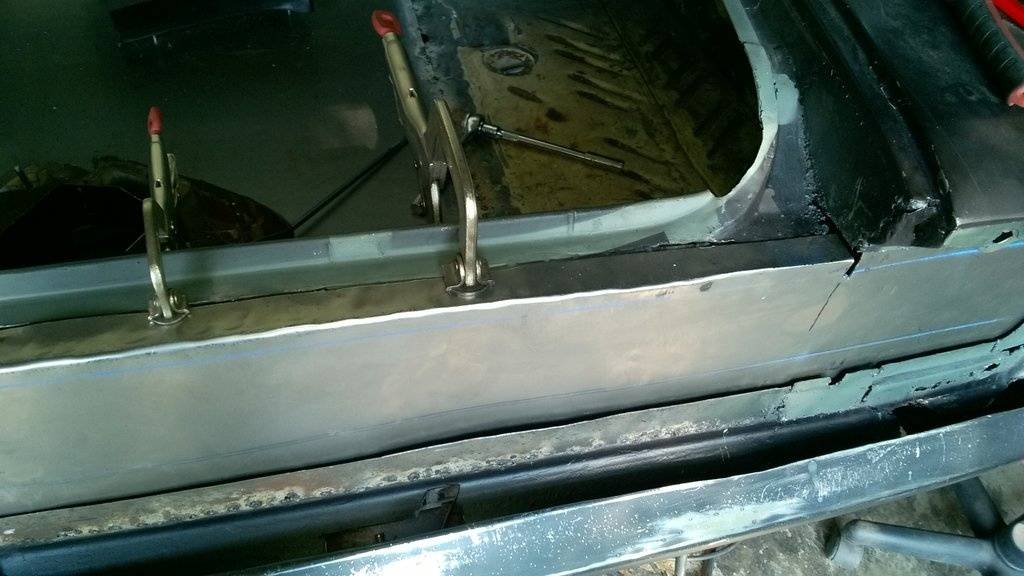

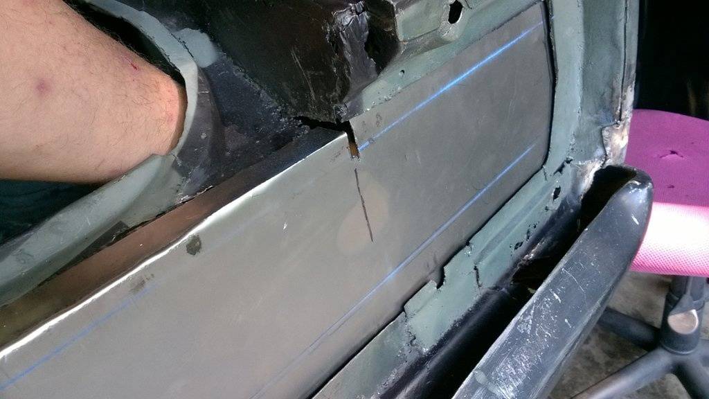

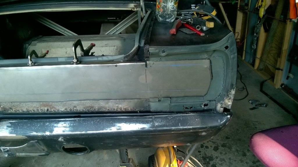

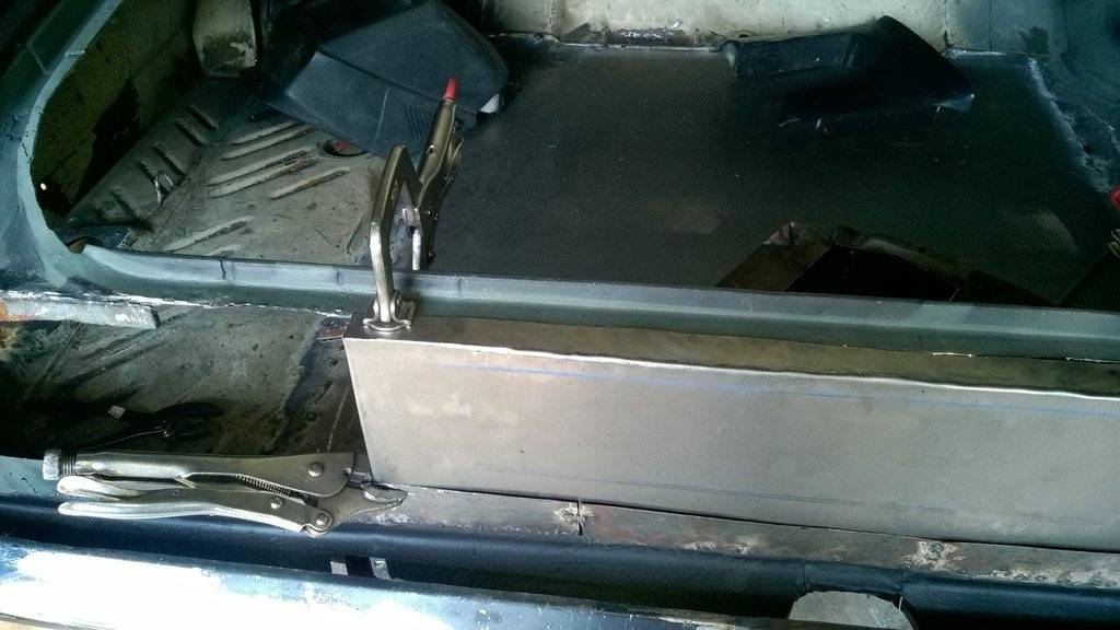

Ripped/cut out the entire housing I originally built for the 66 T Bird taillights. I studied on it for a while and decided to build a plate that attaches to what's left of the original rear wall, after I get that attached i'll cut another layer of 20 ga to go over it that butts up to the original layer. this will give it rigidity, put it at the right spot for the lights to line up with the tail extensions and provide some meat to bolt the tail light body to afterwards. I also folded the top edge over so it meets up with the rear edge of the trunk lip. I will get pics tomorrow so it will make more sense. :lol::icon_fU:
Okay, so, pics.....
WP_20170910_09_35_04_Pro.jpg WP_20170910_09_35_16_Pro.jpg WP_20170910_09_34_55_Pro.jpg WP_20170910_09_35_00_Pro.jpg
