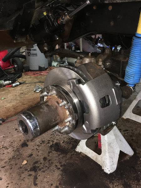

Just waiting on new brake hoses from NAPA now... the rest is done and ready to roll.
It'll be nice having the old 90 Dodge/Cummins W250 back on the road again.

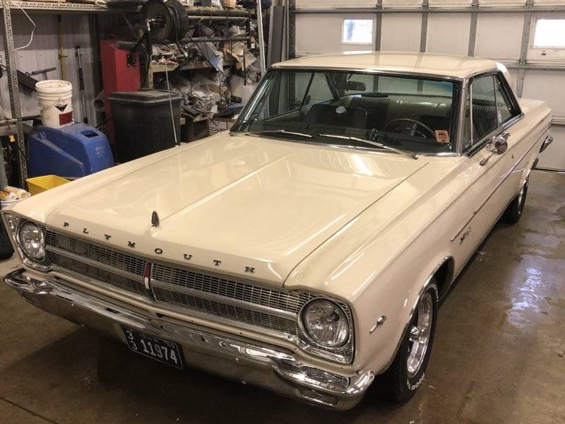

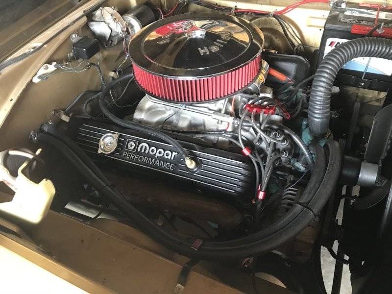

I installed the front bumper and turn signals then took it to 7-11 for a full tank of 91 octane no ethanol gas. First drive in about 2 years or so.
Getting her ready to burn some premium tomorrow. I think she is ready.

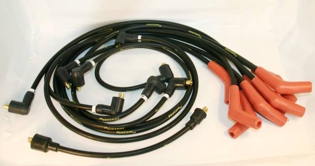

The car has been backfiring out the exhaust for a while now and running like crap. I found a cracked plug wire boot on cylinder #7. I have a 440 with 2" TTI ceramic coated headers. The wires are FireCore50 Pro-Fit OEM 8.5m.

Last night I ordered some Accel Extreme 9000 ceramic boot plug wires part # 9045C. All the reviews I read say they solved the problem with header heat. We shall see.
I've used those; they are pretty much impervious to heat and I never had one crack..but, I was also able to position them so they never actually touched the headers. As I recall the only drawback was, they could be a little more finicky to snap on or take off, just because the boot isn't flexible..but that's no big deal.
There's an installation video saying to put a dob of dielectric grease on the tip of each spark plug before snapping the boots onto the plugs. I'll try it.

For sure. I smear it on the plug's ceramic, even with rubber plug boots. With those accels, it's just that you can't really wiggle them. A trick that helped me was centering the plug terminal in the boot first with a skinny pair of needlenose pliers.
I installed new plugs and a temporary plug wire on #7 (see post #7266 above) because I'm too impatient to wait until the new plug wire set arrives to drive it. Perfect day for a drive; cool temps in the low 60s. I may have opened up the secondaries a few times with my great nephew along for the ride just to blow out the cobwebs as it's been sitting in the garage for years.

Montana is back on all fours again now after replacing the bad U-Joint in the drivers side steering knuckle. Of course, while I was at it I swapped everything else out for new from the King Pins to the Rotors and Calipers. I bedded in the new pads and rotors this morning and took him out for a test drive. The Cummins was purring like a kitten, and those recent pesky steering issues are now history. I deserve a beer... just as soon as I get off work.

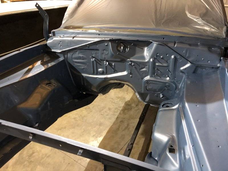

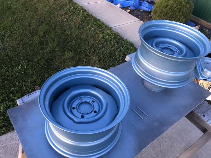

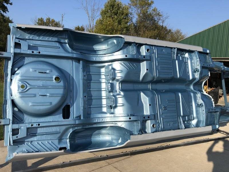

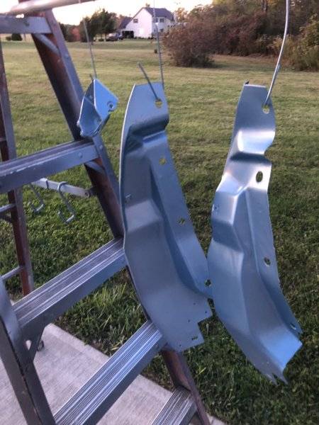

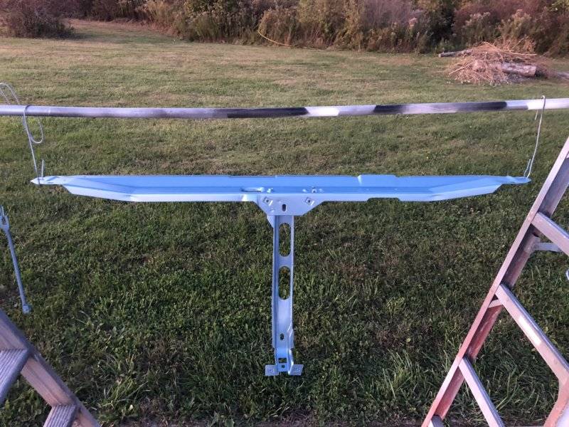

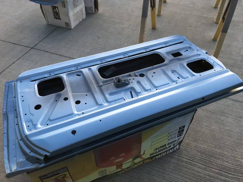

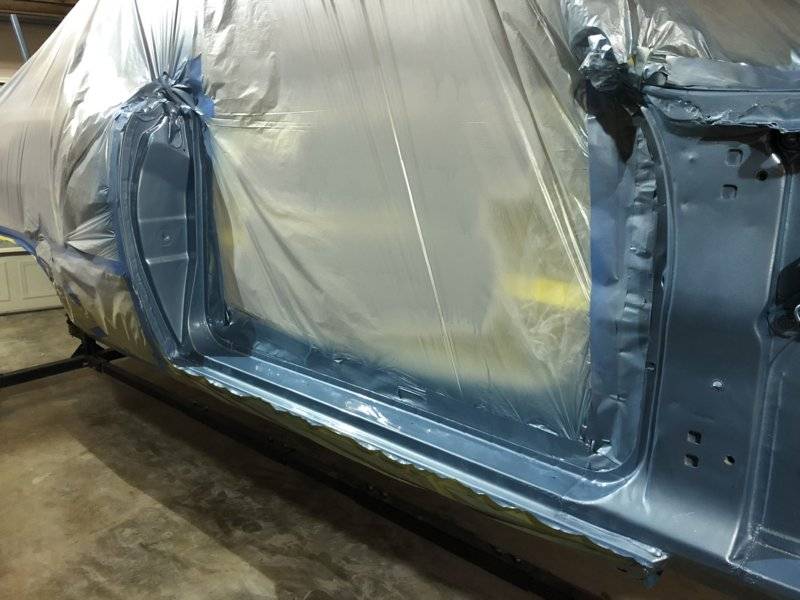

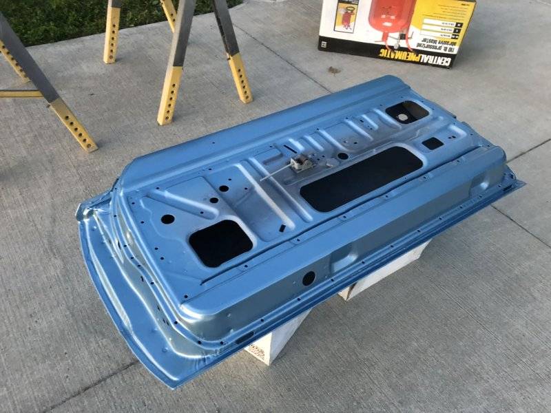

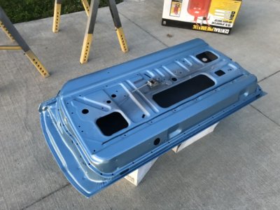

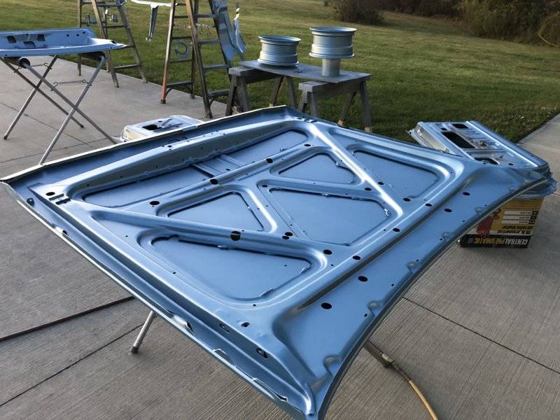

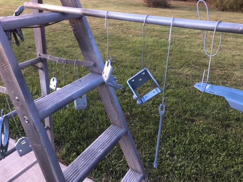

Deck lid, hood, door insides, rear wheels, and some misc stuff is in base. Clear tomorrow.
23DA38CE-69FE-43D7-89D5-D9B2D655CAB6.jpeg 1428AD7E-0F57-4043-81A9-2A1EDA0CA298.jpeg 79BBFF44-FC98-41AA-82AE-40051CCA828F.jpeg 9CE3D743-E87B-449E-8784-0C0533256CEA.jpeg 755DE5DE-716B-4613-989A-9276FB866ECB.jpeg CE04D65A-5489-427F-A458-723AB84457A3.jpeg DD89BD66-83A4-48CE-9448-F6DBEAB24205.jpeg 26922B0C-694E-4E7F-AADA-C4CF2FC2F6A0.jpeg
