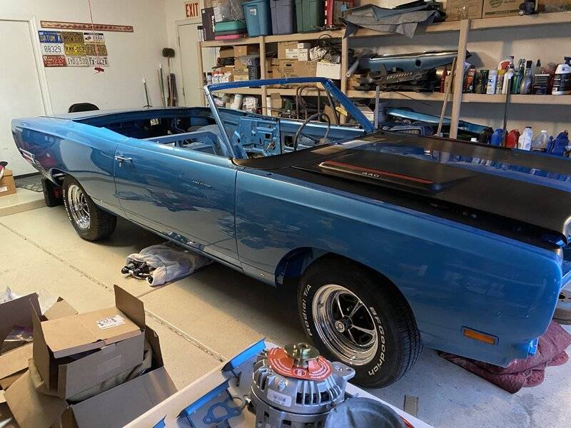

I did put the new wheels on, got the headlight stuff put on. Tomorrow finish all the engine compartment stuff.
I did put the new wheels on, got the headlight stuff put on. Tomorrow finish all the engine compartment stuff.View attachment 1046467
F**k that's nice.

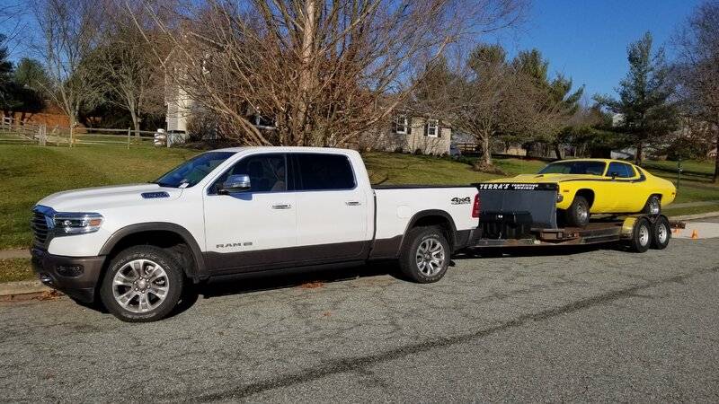

Put the 73 Road Runner on the trailer to tow it up to my father-in-law's place.
This car is nothing special and not worth a whole lot of money (it's a well equipped 73, with a 340, 727 & 3.55). It is a bit rough around the edges and the body and interior need some TLC. Also, the engine threw a rod so now I am slowly working on a stroked 340 for it. What IS special is it's my first car I owned, so it has been titled to me since 1981. My son and I now co-own it. It was his first car too that he used all through high school and college.
3.55 not too common in 73.

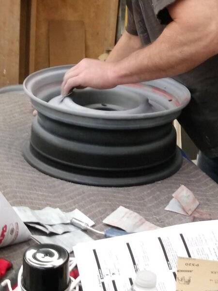

What better time than a shutdown week to borrow the spray booth at work to finally get the steelies done the right way. Had them blasted to bare metal, after that I etch primed, filler primed, 3 coats of Shop-Line JB MM1 Turbine Bronze base (Ditzler 60492), 3 coats of Shop-Line JC630 polyurethane clear and voila, lookin better than ever. Bought a new inexpensive hvlp gun for this job. Worked out great. Do you need to spend a lot on a high end gun to get really nice results? No. If I ran a shop that I relied on my gun to earn a living? Then yes. All depends on your situation.
