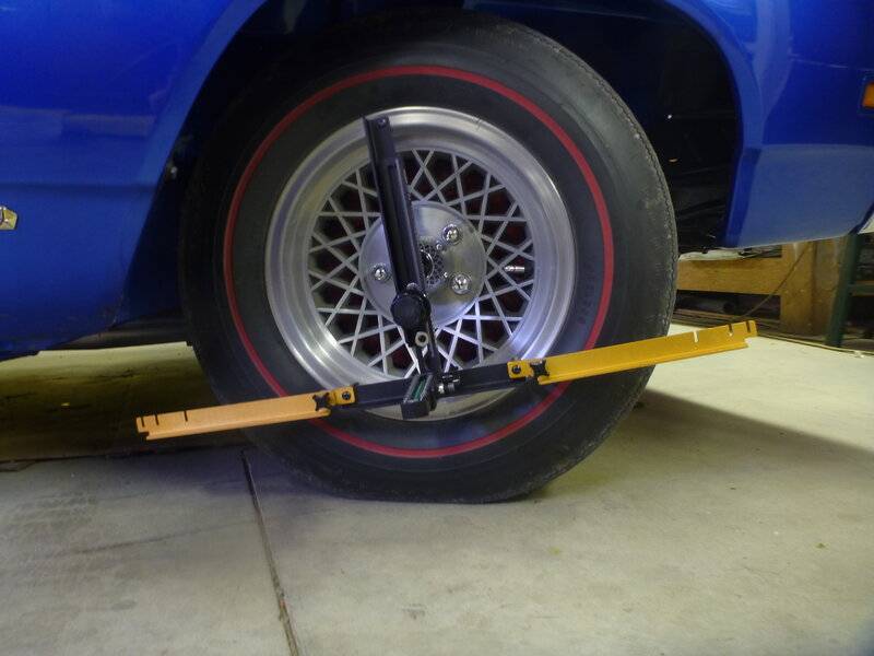

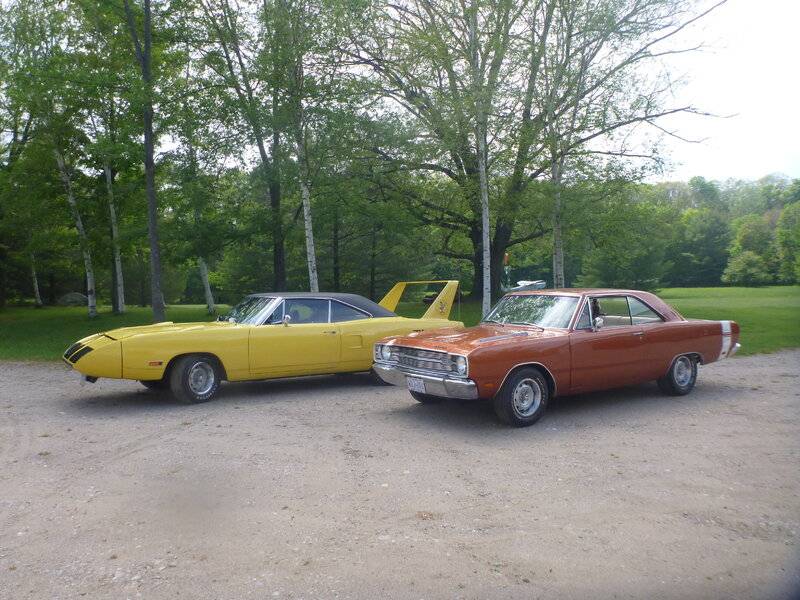

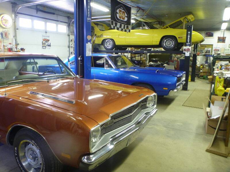

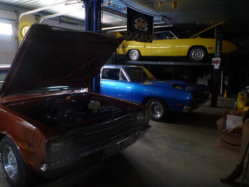

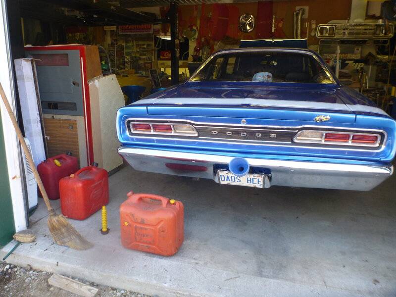

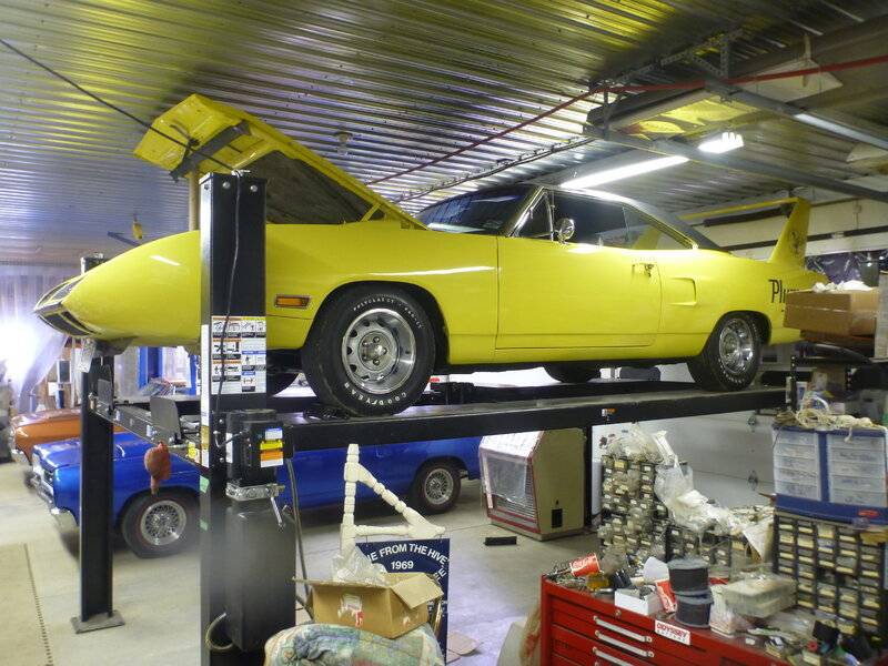

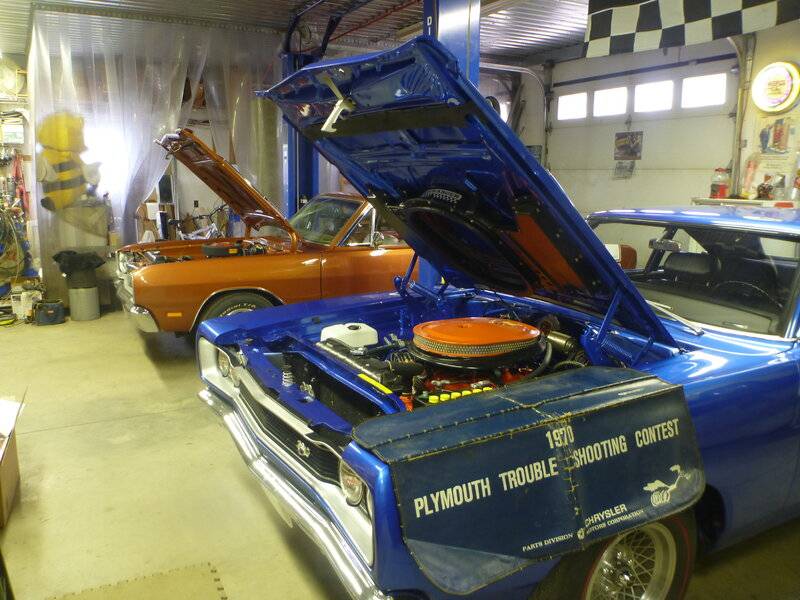

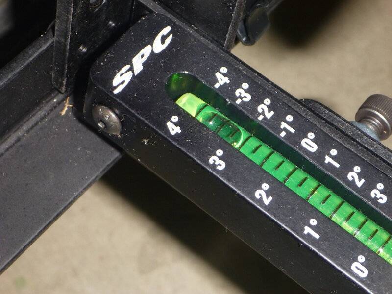

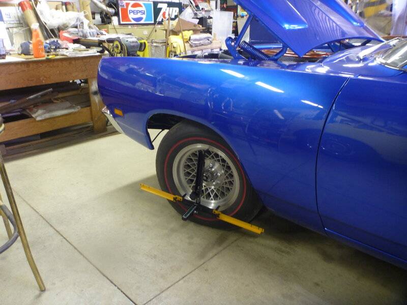

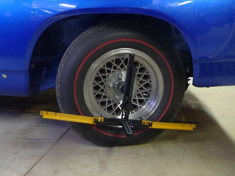

Fueled up the cars for Sunday's cruise with the kids and then thought I'd play with my new SPC alignment tool. I know why the Bee pulls right slightly now. While trying to get 3* caster and settling for 2* on the drivers side, somehow my alignment fella set the passenger side about 3 * NEGATIVE !! I thought it was the tool vial or something at first, so checked the other cars. Nope, Dart caster is 3.25 * POS on both sides. I'll get the Father's Day cruise out of the way, then put her on the 4 post with some greased plates under the tires and see if I can sort it all out.
View attachment 1124960 View attachment 1124962 View attachment 1124963 View attachment 1124965
Sadly it was an FBBO members Son that did my alignment. Maybe we were doing too much talking vs paying attention to the machine read out! LOLPlus, just what you're describing that they did on your Bee alignment is why I don't trust those big shops working on my old classics anymore. I'd rather do it myself so I know what I've got when I'm done.
Nope, done at a stealership.Ooops! Wasn't any beer involved was there?![]()
