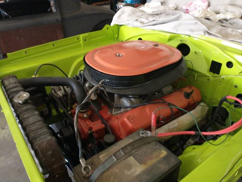

Started my rebuilt 440 for the first time
Was totally amazed that all the parts that came from many different places played nice together as I started with a bare block and had to find everything else
Pulled the distributor and oil pump drive gear out and made up a rod to go into the oil pump that I could spin with the electric drill
Got it all primed up and distributor back in
Added some gas to a can hanging on the inner fender to feed the fuel pump
Cranked it over with no power to the coil yet till I could see the gas in fuel fitler
Cranked it a bit more to get some in the carbs
Poured a little gas down the middle carb and added power to the coil
Engine turned half a turn and it was running
Was a good guess on where to set the distributor
Now to get some water in the rad and let it run and warm up
It is running in this picture but hard to tell without a fan blade on it yet

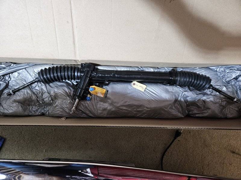

Got my rack back from Unisteer last night. Rebuilt, parts replaced and sent back home for free. The rack and pinion units for B-Body was disconnected in 2019. They were great to me when I needed help and I won't forget it.

Opened the box and it's a new rack and pinion unit. I called just a little bit ago and asked what happened. She said the machinist looked at mine and then went and found ONE on a shelf left from when they sold them. He asked Tracy, the gal that works there that I've been working with, if he should even bother rebuilding it, she said, send the new one. I told her I didn't get the tie rod outer ends. She went back and found my old ones and a new set and is sending them to me. I asked her how much I owed her, she said nothing. I told her to make up a receipt for 50 bucks and buy everyone donuts. She laughed and said, no way! This company, Unisteer, is incredible and I will never forget it!!

Some companies are just exemplary! Wish there were more of them out there....
