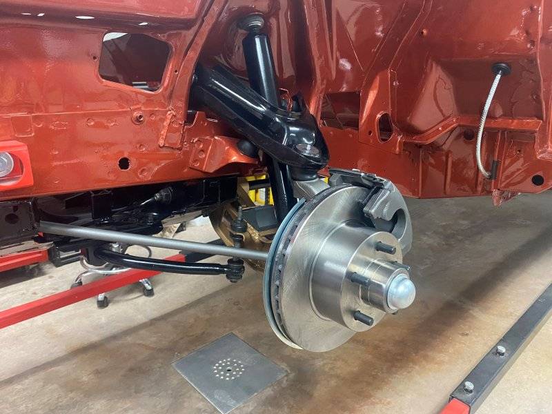

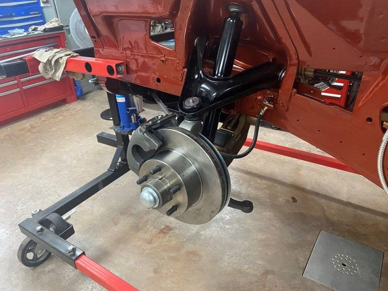

Not today but on Sunday and Monday morning. Managed to install the front brakes and spindles twice on the Charger. If at first you don't succeed, try try again. lol
Don’t feel bad, I did that once 40 years ago.
I thought that you mounted the brakes on the rear due to interference with the front sway bar on the 70 Charger. Not. lol Wasn't to bad. The ball joints popped right out with some tension with a outer tie rod end removal tool and a tap with a BFH
