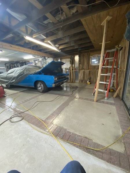

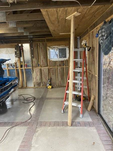

Drove the 68 about 10’ in reverse so I could start the plywood on the shop ceiling. It’s going to be cold soon. It’s hell working by yourself.
