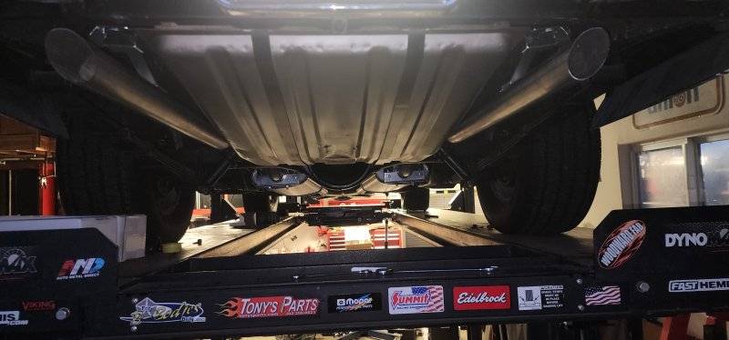

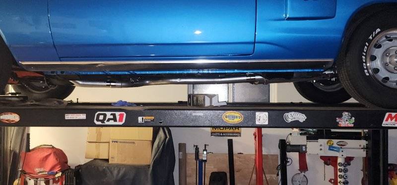

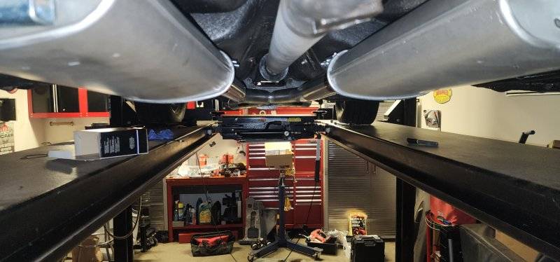

New tti exhaust in. Still need to install the tips.

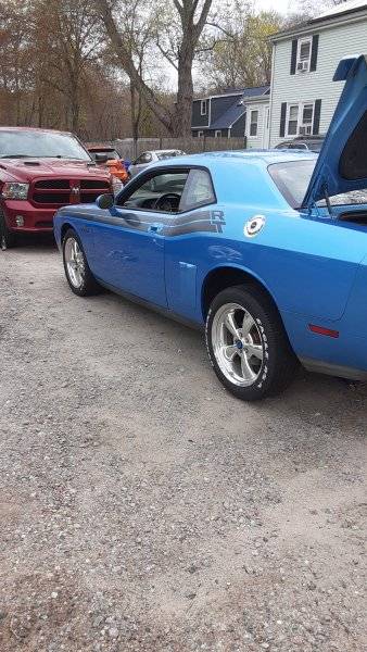

I put some old school Gabriel high jackers in my wife's Challenger! I'm digging the old school look!
Not really, the car was on a jack while I was installing new wheel speed sensors.

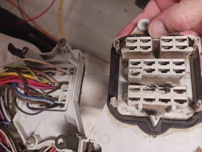

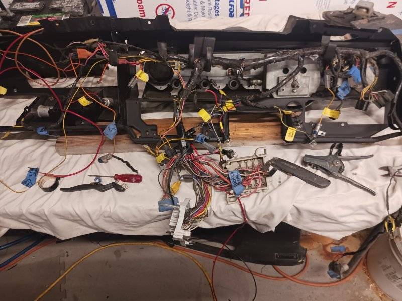

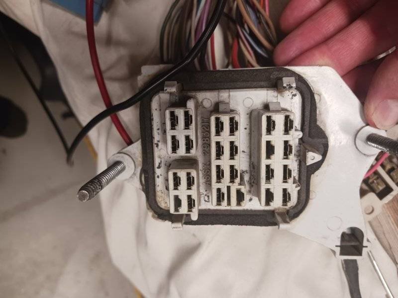

Reinstalling the dash wiring back into the dash frame on 72 Challenger. Replaced melted/damaged bulkhead box with another one I had. Not running the red and black wires through the bulkhead connection box and doing alternator bypass. For now, I have the black and red wires attached to the same ammeter post. It took about 45 minutes to change the wires over as shown in 2nd photo. Undamaged bulkhead connection box in 3rd photo.
