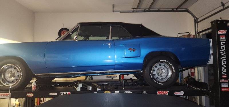

Fixed a horrible rattle in my 1970 Coronet RT that's been tormenting me for years. Came from the rear driver's underside somewhere and sounded like sheet metal slapping together over every bump. Finally discovered that a couple nuts holding a suspension bracket were loose. The attachment points appeared to be two studs coming out of a completely closed part of the frame rail, so I was really hoping that they wouldn't break during tightening, which obviously took a lot of force. Hard to describe how much more enjoyable it is to drive this car now.

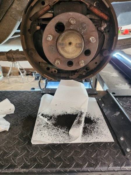

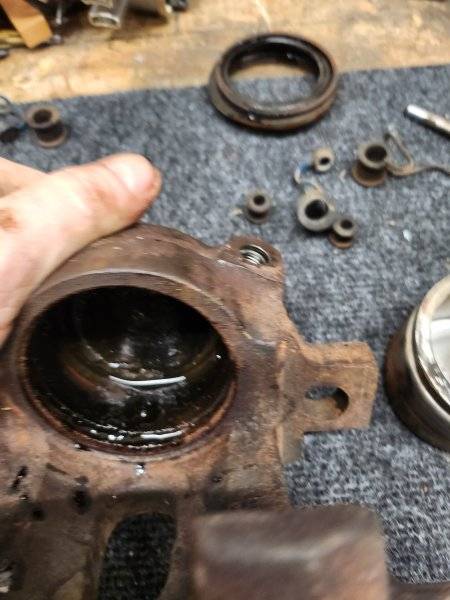

Rebuilt the calipers, master cylinder on the 70 cuda, went to bleed nothing comming out on the passenger front, removed line from distribution block that tied to the line going across the firewall squirts out good, started removing the rubber flex hose to the caliper, 2 shots of pb blaster and time plus a little heat no go. got hotter than hell on that side by the looks of the goo in the caliper and no lining on the pads. ordered a new line and some flex hoses from inline tube had good luck with them in the past. continued to the back replace wheel cylinders shoes and drums from my 68 charger project long ago that was changed to 4 wheel disk, got about $8 into the rears. flushed the three lines out that were flowing, I was worried about proportioning valve but seems to be operating will tell when the test drive comes in a few weeks after the new parts arrive.

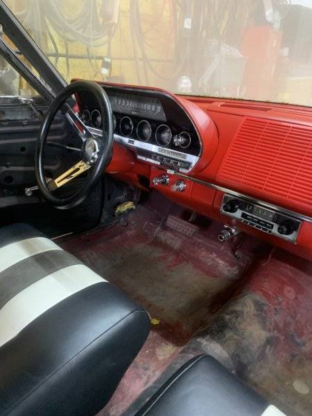

Finished my dash on the 62”, mocked up the new steering wheel, Molotow Chrome marker worked great.

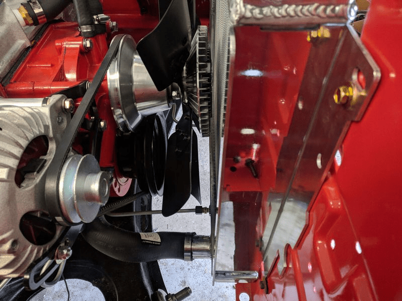

Changed trans dipstick to a different type that doesn't use a o-ring.. hoping it doesn't leak.. and finally got my fan mounted.. Putting on these Hayden low profile clutches is no joke.. took me well over a hour to get it in and not sure it's running true.. no vibration but doesn't look right to me when running.. might take it apart again tomorrow to double check stuff :( Tight fit in there..
P.S. thinking of finding a steel pulley to gain a tiny bit more clearance..the aluminum one is thick..

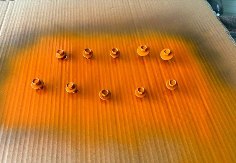

Painted the hood hinges for my new project.
