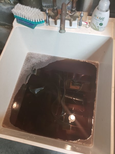

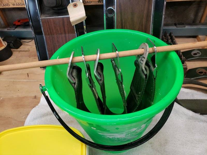

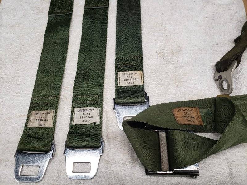

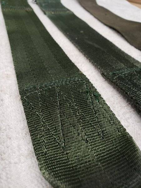

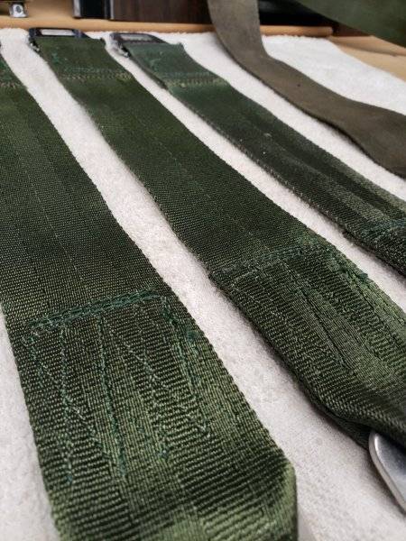

Saw a vid about using one of those cutlery cleaning gizmo's with the brushes inside that cleans both sides of a fork at once. Just slide the belt between the brushes and scrub. Seemed to work well. took a few minutes each belt using liquid cleaner and a clean wet cloth to rinse. My belts in both the truck and the car are really grungy.
OxiClean did wonders for mine! Maybe the spray version with the two sided brush you showed?
I'm sure you don't want to take them all apart!

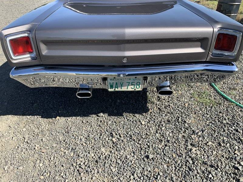

Put these oval exhaust tips on, and finished buffing it out.
Well, your never “finished” but its pretty finished until I do it againimage.jpg
View attachment 1717529View attachment 1717530View attachment 1717531View attachment 1717532View attachment 1717533View attachment 1717534View attachment 1717535View attachment 1717536
No, the trick is to lay a big towel over the seat, pull the belt all of the way out at the top and push the buckle up there and clamp it so it stays there leaving the belt all loose. Then spray the belt with cleaner soaking wet and use the brush. Wipe it off repeatedly with a wet towel till it wipes clean, done, dry with a hair dryer so the wet belt doesn't reel back into the holder and get moldy. You can test if it's clean by comparing the lower end of the belt with the upper end that never gets pulled out.

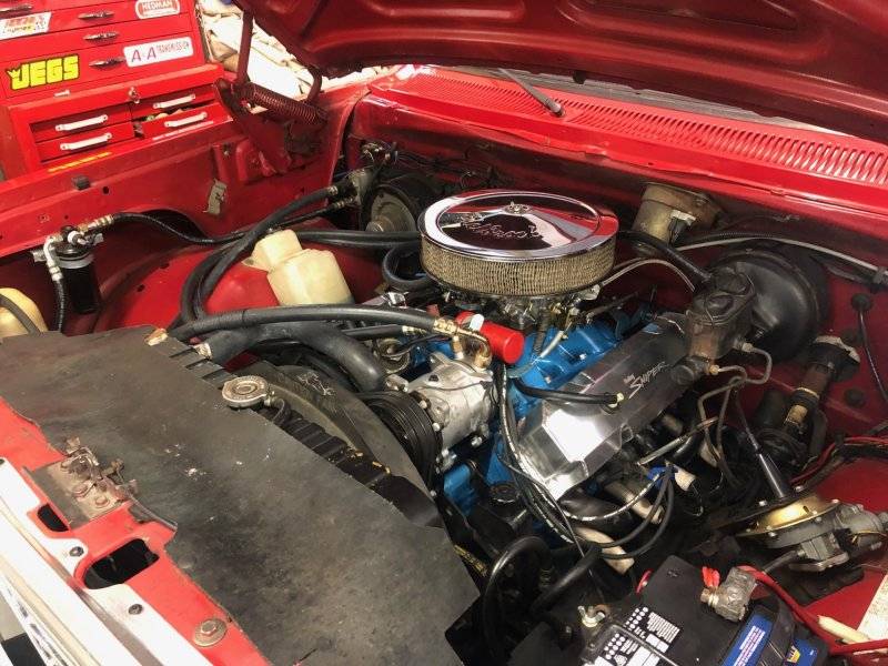

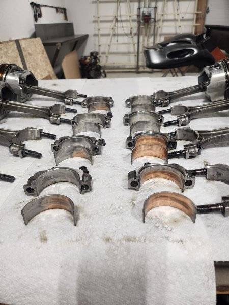

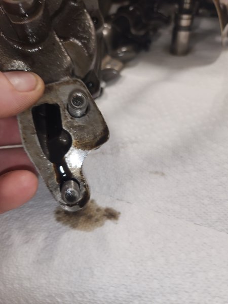

I think it mat have been sabotage, I bought the car from his dad. The motor was in pieces at the said mechanics home instead of loading up parts and taking them to my trusted guy I thought it would be best to have him finish it, MISTAKE.
I've owned dozens of Mopar collectable cars. Regrettably, after forty years I just sold my last Mopar. At 76 years old, and multiple back surgeries, enthusiasm of working on and maintaining old cars is gone.
