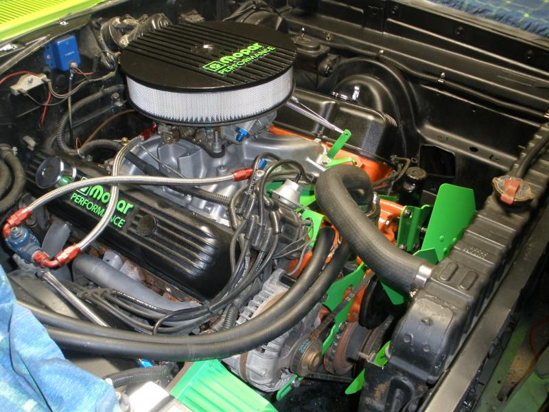

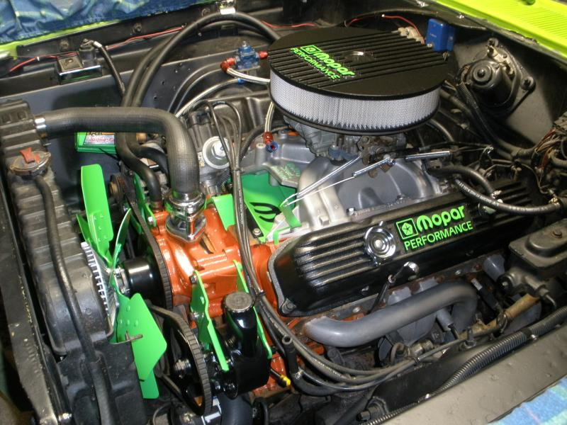

looks sharp with those green accents... different but cool none the less
Thanks, I was looking for something different and was hoping I'd like the finished product. It's not like the car is an original anything so I don't feel bad doing odd things. If funds allow I plan on some taylor hot lime wires :)

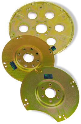

Yep...Most likely they are the culprit. Yesterday we...My Brother and I...worked on tuning the engine up really good. He has a unique gift when it comes to this fine tuning stuff. Not that I cannot do it if I were to have to, it just is easier to watch and learn from him. Thanks again Bro. Any way...we got the 383 purring like a ????. I had the initial way too high...around 30 and now it is more respectable at around 18 degrees BTDC. Smoothed out really nicely and the exhaust note is just freakin' awesome. Later after taking care of some other small things I will start to drive it and see if more work is needed which it most likely will. Got a small stumble initially but that is due to the jetting/metering of the Holley 750. So...while working this and putting up with the knocking I am still having, a MOPAR acquaintance stopped by to visit. He has a 426 cross ram Dodge 440/4speed and is a retired AF mechanic. He was listening to our knock and firmly believes it is in the tranny and most likely the flex plate causing this. When I had one of my re-builds of the 383, I had a HELL of a time getting the Flex Plate off the Crank and wound up "tweeking" it while getting it off. I straightened it as best I could and it seems that maybe I didn't. There are some nicks and dings on the Flex Plate bolts and the Flex Plate itself. Any way...in the next week or 2, I will limp it up to the tranny shop...just 6 blocks away, and have them check the tranny out and the Flex Plate. I am thinking that if in fact that is the case, I will have them swap out the stock Flex Plate for a round SFI unit either 10 3/4 or 11 inches. If I go 10 3/4 I will need a new torque converter and if I go 11, I can use the one I already have. I value this chap's knowledge and opinions so I am taking his info and run with it. So as it stands right now, the tranny and flex plate are the cause of the knocking noise. Just got to get her fixed and this 1966 Ply Sat will be on the road and the tires "SMOKIN'"....:blob1:
good luck buddy, that bent flexpalte {or cracked or loose, make a bad knocking noise too} will take out the converter & front pump too, I would highly suggest, that you "tow it" even flat tow, with a strap is a better idea, especially if it's only 6 blocks away, so you don't comlpetely wipe out the trans &/or put a ton of metal shaving thru the front pump or something, with her driving/running... my $0.02 cents
the sfi flex plate is a great idea, the round SFI cert. B&M w/dual converter pattern unit is only like $83.95 from Summit Racing
