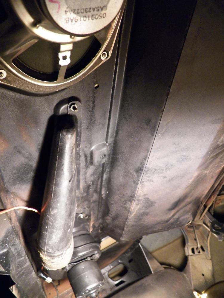

I installed my rear defroster and speaker.

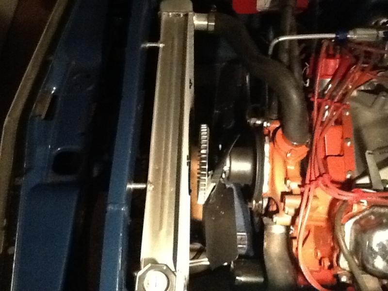

Hey snake, looks like we have the same summit 3 pass radiator (made by northern). How do ya like it? Does it cool well?
No cooling issues other than taking forever to get up to operating temp.
My gauge has yet to go over 185* and I've been racing around all day tuning the carb in 85* weather.
I wanted a shroud at first, but I just don't see the need.
I might actually go with electrics instead

Great news. i just never want to worry about overheating again, even if stuck in Jersey Shore traffic in the summer. Sounds like you need a different t-stat? This past fall my car wouldnt come up to temp on a cool fall day. I opened it up and realized the PO drilled a few 1/8" holes in the stat for hi flow, which i hear does have its purpose. I plan on running a standard 190* stat, maybe 195, which 'should' allow the car to hit temp before even bringing the rad into play.
