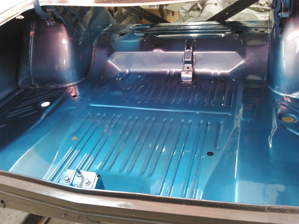

The thing is that the car will come to Spain. That´s why I want to do all the technical and mechanical works in USA and then, after bringing the car home, do the appareance works here (interior and paint job). Do you thinks it´s a mistake to do it so?

Thanks to everybody for your replies! Regarding the rotisserie and the metal work...car will go to a body shop. Do they have those kind of things there or have have I got to purchase it by myself? Any advice of buying it? I have been told to make as much room as possible in the rear quarters for some big rubber...Any other advice?
Frame connectors from US Car tool
They also have a mini tub kit. I would also do the rear spring relocation if you want max tire size.
