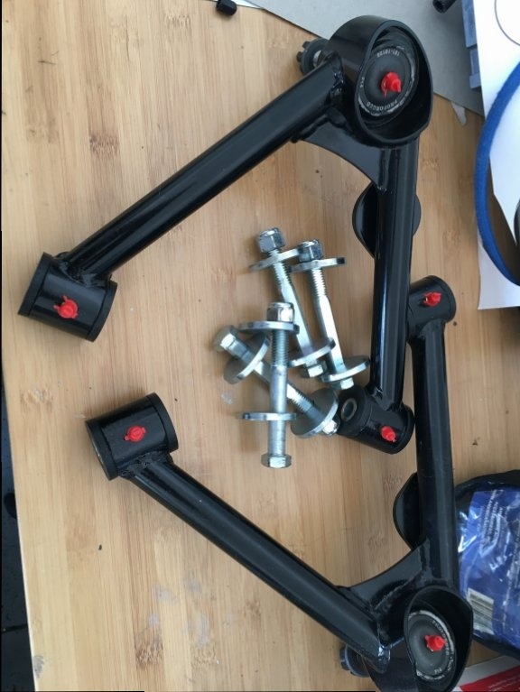

Hey Max, the qa1 is a cheap way to get good performance out of these things. I have a set of brand new tube uca w/ bolt kit and weld in braces for boxing the lca for sale. PM me if you are interested. Thanks

Duh - upper and lower control arms - what brand - do you have pics and price you can send me?
The upper control arms and bolt kit are Qa1. The lower braces are just a set I got online from eBay. I also upgraded to energy suspension polygraphite ball joint dust covers.

How much more camber/caster will the QA1 stuff allow vs stock and are they lighter than the stock pieces?
Nice write up Al, so weight is pretty much the same and you get -2.5 to +2.5 degree range.
