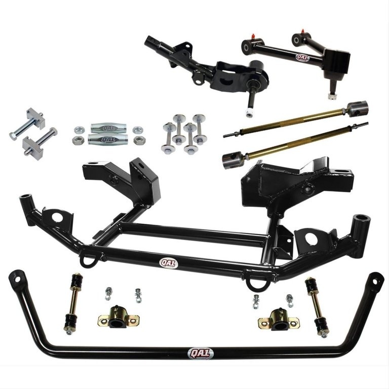

QA1 the ones I have has OE rubber bushing
& sway-bar attachments welded on, factory locations
in the lower Control Arms
just a lighter cleaner looking tubular arm, instead of stamped steel
SPC UCA's also have rubber/Poly bushed ends on the top too
lighter, not by much thou, way more adjustable than OE stuff,
actually adj. on the car too, both camber & caster
QA1 K-Members #52314 {IIRC} have OE style motor mounts too
{they claim 50#'s lighter, with their UCA's & LCA's}

I am not trolling the likes of RMS, Hemi Denny, QA 1 or Magnum Force to try and sway me. I would even go ahead and admit that their systems do look nice. The owners seem to like them.
$1799 QA1 Stage 3 kit,
can't remember if it was Jegs or Summit Racing
