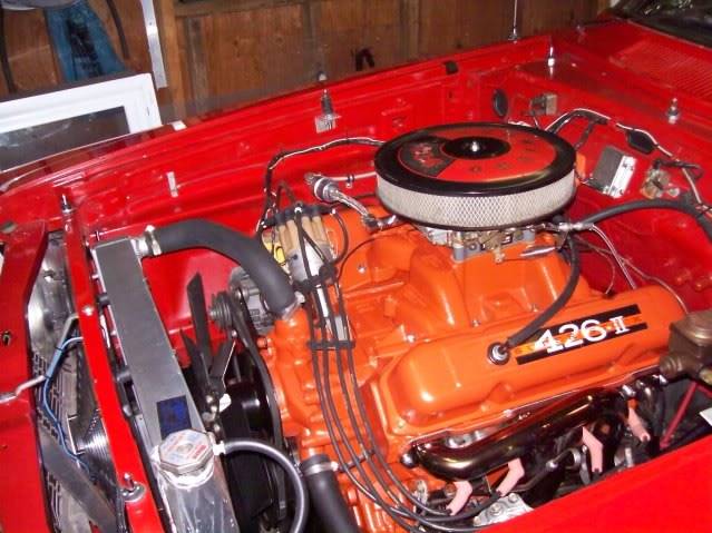

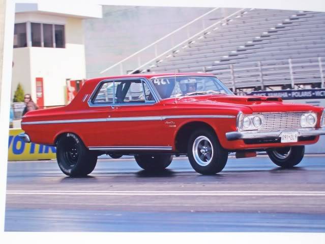

I built my dream wedge. I always had to build budget engines but after I got divorced 2 years ago I decided to build the eng I really wanted. I wanted my 63 to drive to the track and then run 10's on pump gas and drive home all this thru the full exh. So here is what I built:
Its a 493 which is a .030 over 440 block with the 440Source 4.15 crank stroker kit with dished pistons. I studed the mains and use steel main caps and had it all lined bored. I use Indy EZ heads ported to Max Wedge size and cut a tad for 10.6 comp as I wanted it to run on 92 pump which it does as I built a nice .045 quench. Hughes 1.6 roller rockers and I had Dwayne Ported custom grind a solid flat tappet cam for me of 264 and 270 @ .050 with .634 lift using the 1.6 rockers. Has a 110 LSA and I installed it at 106 CL. I use the Indy dual plane intake which works great. Carb is an 850 DP and a Mallory dist wih the MP orange box. I use TTI 2" headers and their complete 3" exh with X-pipe. Its in my 63 Sport Fury with a 9.5 Dynamic converter and 4.30's with a 30 x 9 tire. Drove it to the track once so far and it ran 11.04 @ 121 running bad as it was still to lean bucking at the top of the gears. I know it should run easy 10's next time out when I jet up some more. It drives great as I drive it all over. I drove it the 180 mile round trip to Carlisle in July right after the eng was done. I spent a good 7k in all the parts and built it myself but I have the eng I have always wanted. Ron
