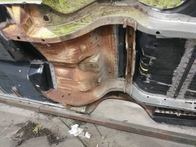

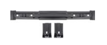

I bought this trunk floor reinforcement set from Classic Industries a while ago and essentially removed whatever left from my rusted trunk. I know where the reinforcement bar goes, but I don't know what the two smaller pieces are for or where they go. Can anyone help me?
They are suppose to be welded to the tailpanel and to the trunk floor. Basically they stand up vertically, one on each side of the trunk latch.
That makes a ton of sense! Thanks. My rear was so far gone due to rust that I've had to replace or fabricate most of it. Lots of fun (which I bought a project that most would have walked past).
trunk floor support and gas tank hanger brackets
your rear cross member has provisions for gas tank straps, these go on the other end of the trunk pan, and accept the J bolts that hold up the front of the straps
