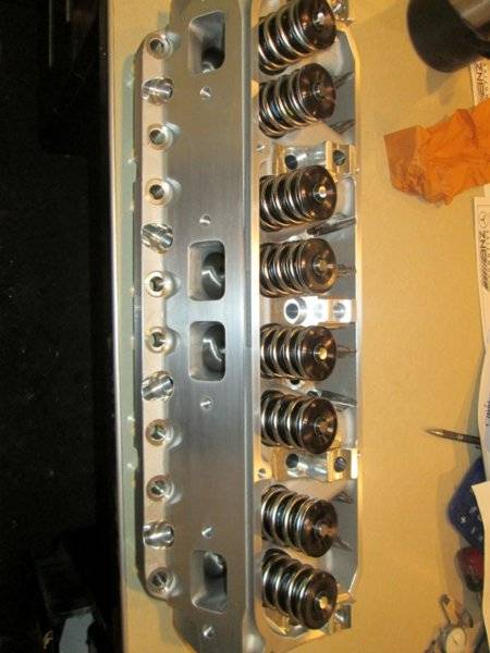

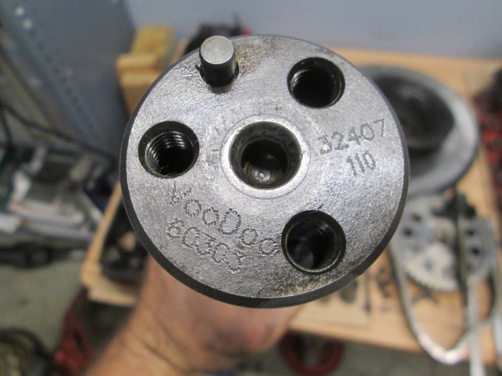

250# Seat pressure with 640# open @ .600" Lift(assuming 1.5 RR) is around a 650# Rate per Inch Valve Spring ?
That my friend,
is a "Drag Race" cam ramp profile, just say'in.... How LONG do you intend to run this cam profile in the Street driven application ? between maintenance and V/Spring inspection/pressure checks ?
(FORGET what David Vizard's book says), that don't make ME nor anyone else for that matter a REAL Engine Builder.
