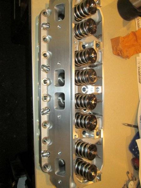

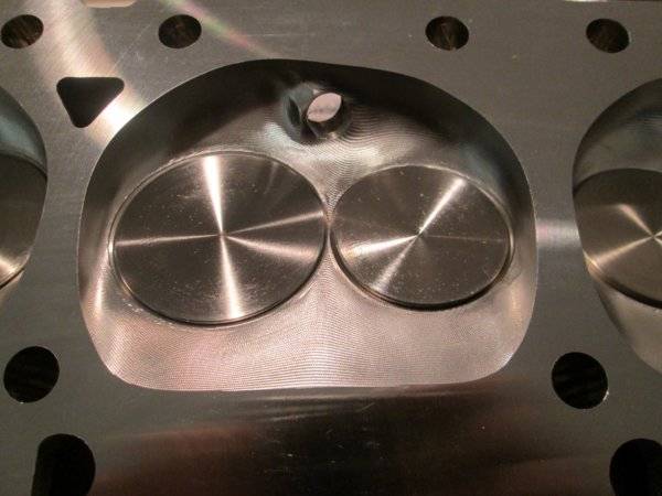

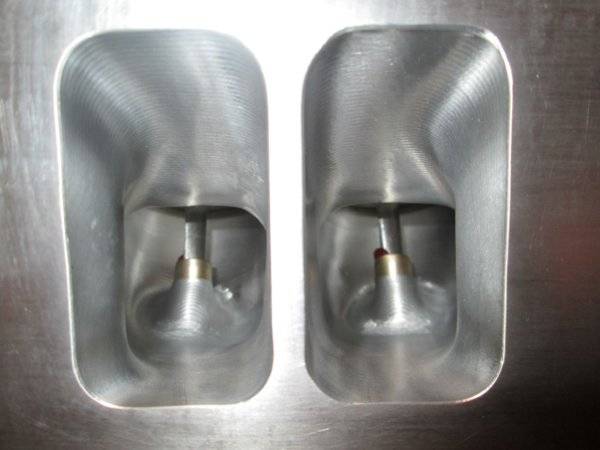

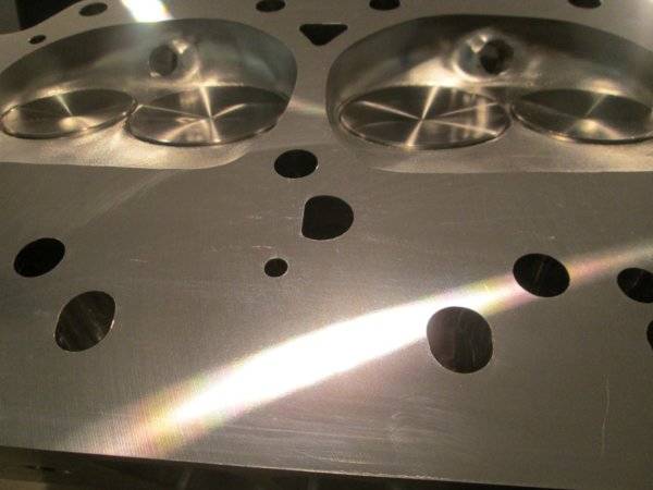

The heads arrived today so here are a few pics if someone wanted to see what they look like. Overall they look pretty nice.

View attachment 539707 View attachment 539714 View attachment 539715 View attachment 539716

because someone pointed out the RACE Cam profile you using requiring 650# Rate per Inch Valve Springs, you are then planning to run on the STREET driven environment, may.... just "may"..... also require an enhanced regime to inspection and V/Spring maintenance for best results on the STREET ?
