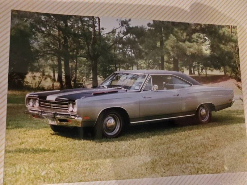

My A87 has no chrome tips FYI. Build sheet calls out A87 thou I think all of the above yes. My buddy’s 69 (he ordered, no tips but all of the above)

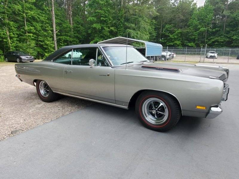

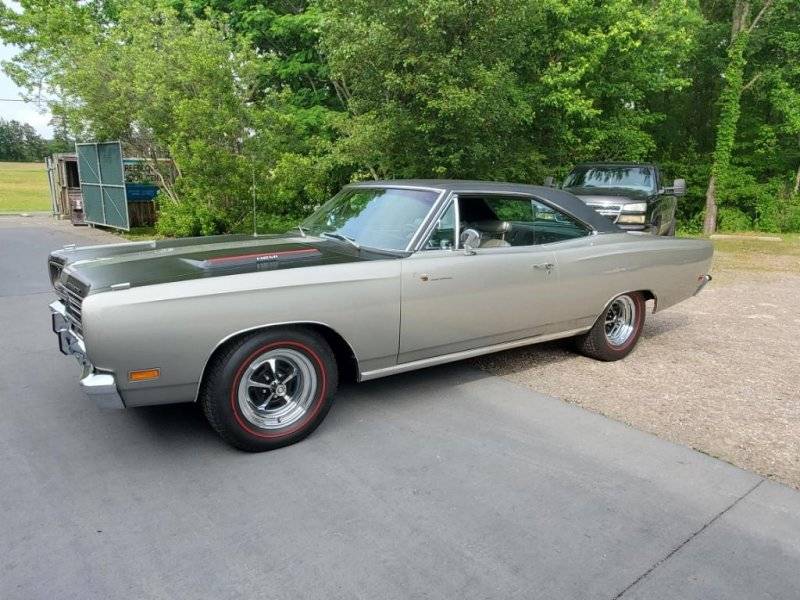

Here’s another Hemi and has rocker moldings. My other buddy’s car

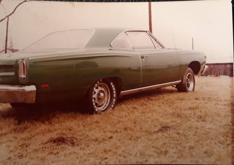

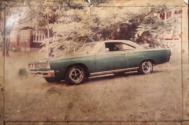

I cant comment if my car had A87 or not, its been gone a LOOOOONG time . I sold it early 90s I think.
Last known location was in WI.
These pics its 100% original paint and was untouched except wheels/tires and drive train
99 Rallye green , hemi, 4spd, 4.10 dana. manual str, pwr disc brakes, blk interior bench seat car

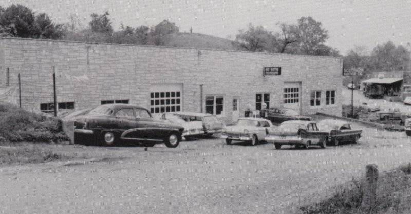

Sold new at Scothorn Motors, Petersburg Ky. Grandmother bought it new for her grandson who had just graduated high school. True story

Your correct and as the case for my buddy’s a4 silver car he removed his (non optional on RR)

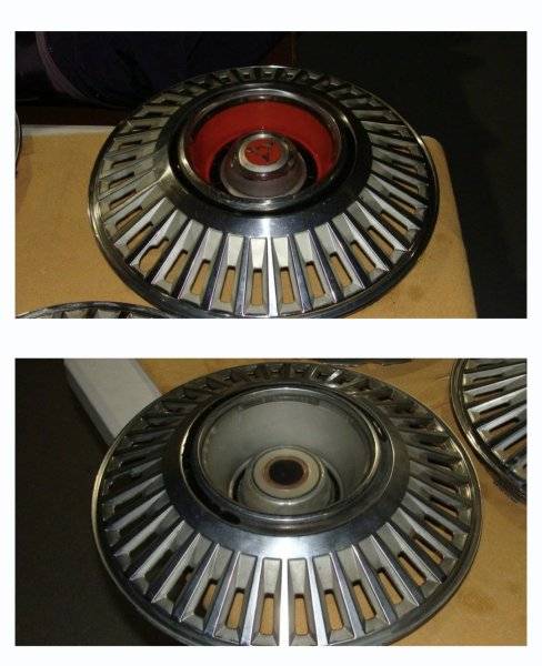

Standard on a 69 rr (except A12) would be matching paint steelies and dog dishes, wheels would appear on broadcast, as would tires, but dog dishes would not be necessary.
I'm pretty sure optional wheel covers, wheels and tires would appear on the broadcast.
The nine slot covers were W11
The deep dish were W15
The hemi covers were W21 (code for hemi only, as we shall soon see...)
The chrome style (14") road wheels were also W21, on 383 cars.
The KH recall 15" wheels were W23
Along with seven different tires available, depending on engine choice.
I am NOT the expert, this is from Wes's 69 rr book. He is a member here, can't remember his member name.
