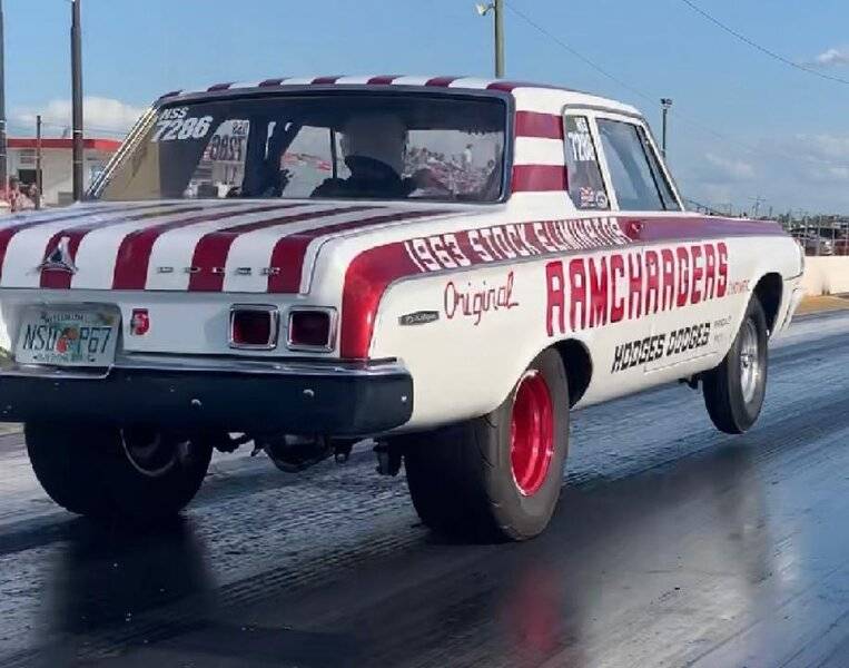

First trip to the track coming this weekend in my new-to-me 64 330.
10:13 127mph...........................
Here is the set up:
512CID
10.5:1 compression
Edelbrock Victor Heads
Lunati cam .600/.600 106lsa
dual eddy 1407's on a crossram
727 trans with 3000 stall
4.30 gears
ladder bars
competition engineering 3way adjustable shocks
Mickey thompson 315/60/15 drag radials
Car has fiberglass hood and front bumper, lexan windows, back seat delete.
Give me your best guess and I will let the winner know on Monday. No prizes, just bragging rights.:thumbsup:
