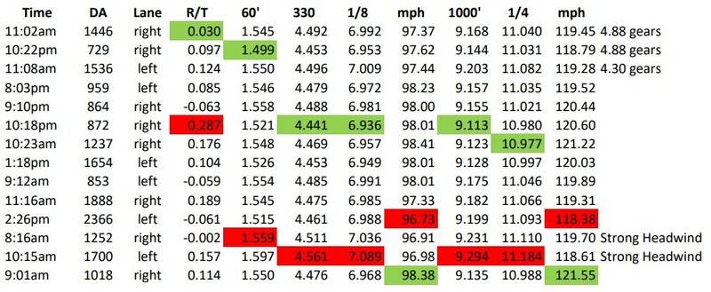

Times over the weekend ranged from this time of 10.977 to a slow run of 11.184, but this run was in the heat of the day with a headwind of about 15mph. Below is a log I have been keeping of my times. What I am not understanding is the inconsistencies in how a good 60', 330', and/or 1/8 mile time will not consistently reflect in the 1/4 mile time/speed. Is this related to shift points, something in the tune, or something else. Green highlights reflect best time/speed, red is worst. You can see on the log where I changed from 4.88 gears to 4.30 gears. Advise and criticism are welcome! I did get the car weighed. It came in at 3418 with me in it (about 190).

Throw out the quickest and the slowest. Now what do we see? Mph looks pretty steady. So from a power stand point, things look pretty consistent. The 60ft is all over the map. So are the R/Ts. But the two don’t line up. Slow R/T’s with a quick 60ft’s or vice versa. So I don’t think this issue is being caused by inaccurate staging. At this ET level unless something is really wrong, traction shouldn’t be an issue. So that to me leaves two items I’d look at. Carburetion and converter. One or both isn’t right
Doug
The way I see it....... it doesn’t have enough power(speed) to run a significantly better ET.
The 60’ times still seem a tad weak for a 500” motor in a 3400lb bracket car.
