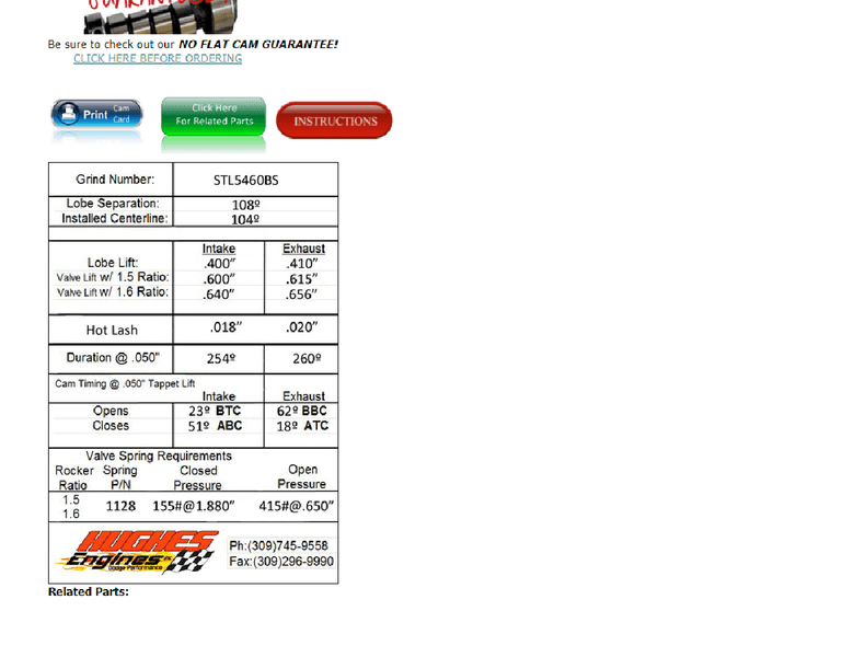

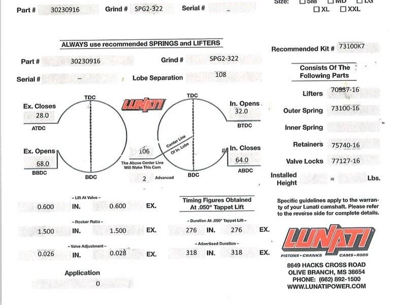

For additional info, here is the cam card.
To run a cam in the duration range of what the OP has, I’d really want to have 165lbs on the compression tester......as the minimum.
My catalog showed 322 advertised duration for that cam...... which is what I used in the calculator.
At 318 the IVC closing point would be 2deg earlier, which would have made the calculated number of 135psi go up a tad.
I was using a c/l of 104deg for my results.
I didn’t see it mentioned anywhere........
