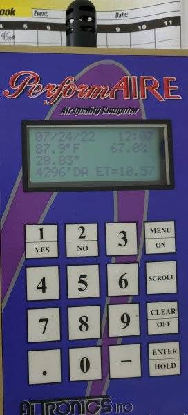

Getting close to the 10.50 index. Air was REALLY good with DA of -200ft
-200 D/A, I can't imagine air that good. My best run of 8.98 was at 2900D/A.
Doug
All of this important talk about "good air" reminds me of the weather in South Louisiana and Mississippi in the fall, winter, and spring. The several years that my car club rented a local drag strip, the event was held in the winter, when "bluebird skies" and cool/cold, dry air is abundant. Compared with the 90+% humidity and 85-90° temperatures at night in the summer, those beautiful days are great for racing.
Wonder what the ET difference would be vs the -200da?
