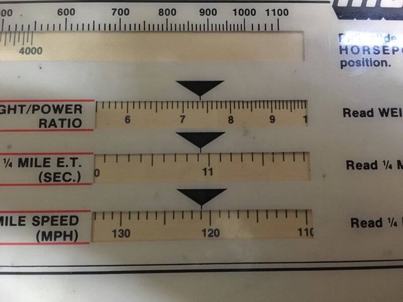

Here’s the Moroso chart......
121mph lines up with a 10.92
So they’re close to the actual best of [email protected]
Typically when they’re off from each other(actual ET and speed don’t line up), the speed is better than the ET....... unless the motor is laying down on the top end.
