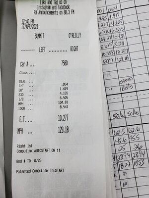

My combo is back on page 4 #63. I run TTI 3" X-Pipe and magnaflow mufflers 99.9% of the time not trying to set any personal best, just seeing what changes pick the car up and how much. This time slip was with 50lbs of ballast. Low maintenance car. I had the tranny freshened this winter and ATI check the converter, only needed a bearing and race replaced kept same stall. I am going out this Saturday for TnT so we'll see if any of helps.
