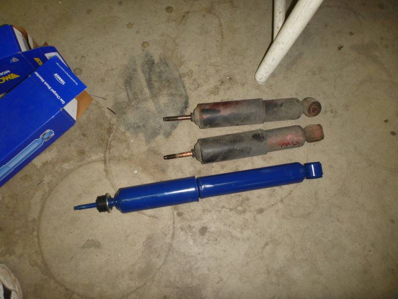

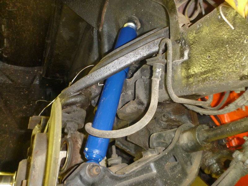

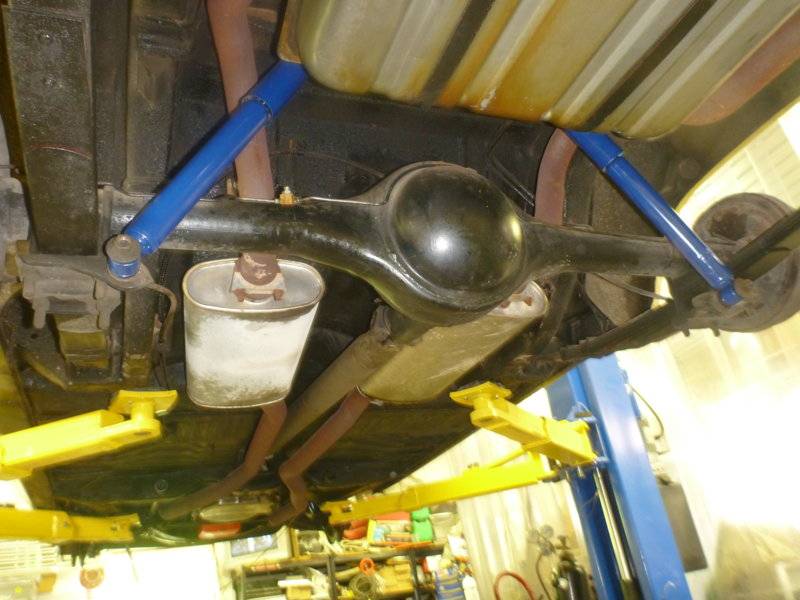

I just bought off the shelf Monroes for both the Bee and the Bird and both ride just fine.. Bird didn't even drop the front right on the track at Atlanta.
