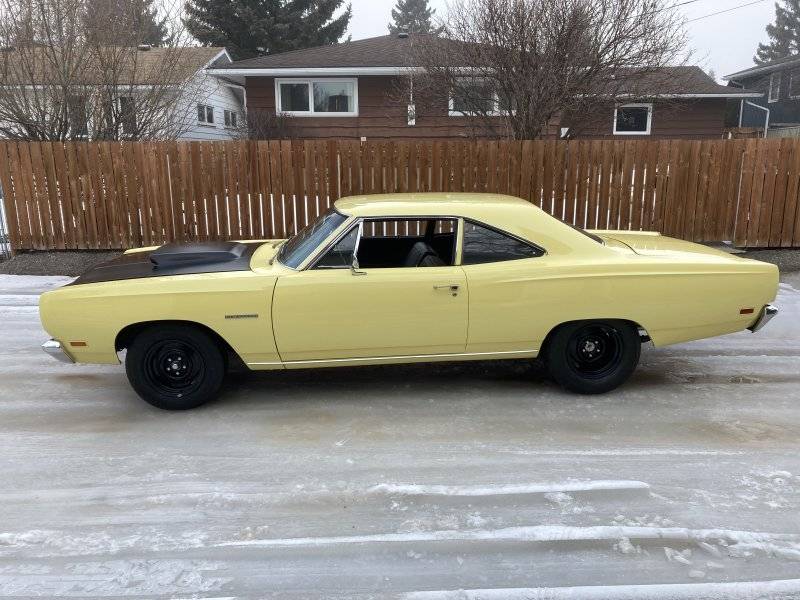

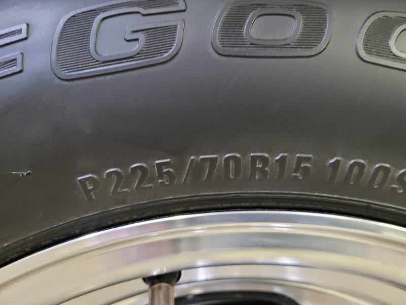

On my 69 roadrunner fronts 225/70/15 7” rim, rears 255/60/15 8” rims. Maybe the rr geometry is different (?) but that combination had a nice looking moderate rake.

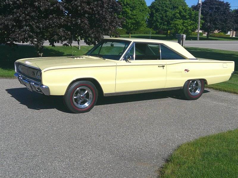

I have 215R70X15 fronts, and 235R70X15 rears on my 1967 Coronet R/T. These '66 and '67 B-bodies likely have the most confined wheel wells of any of the type. I found that 225's on the front would rub the front frame rails on my car, at full turn. I run 70 series, because I like the taller sidewalls. I had 255R60X15's on the back of my 1967 Coronet R/T wagon, but I had to custom make a 15"X8" rear rim to get the clearance I needed. I don't remember the backspacing.

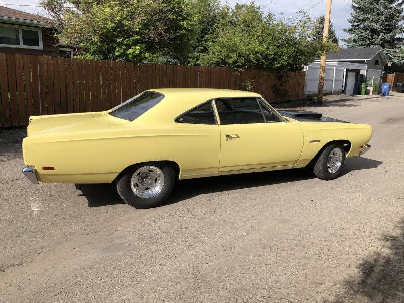

Easy answer. Try the rr wheels on the Hemi car.
( and frankly, that's almost exactly what I'd recommend for the Satellite. Maybe a bit shorter/smaller on the front)

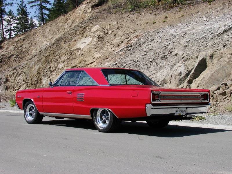

I ran 15X7's with 235X60X15 on my Hemi Coronet. I didn't want a boy racer look to it and didn't feel the need to max out tire size and change ride heights.

Thanks. Thats an interesting point about the taller side profile of 70s. The roadrunner has 225/70s on the front but the original owner modified the fender lip to accommodate.

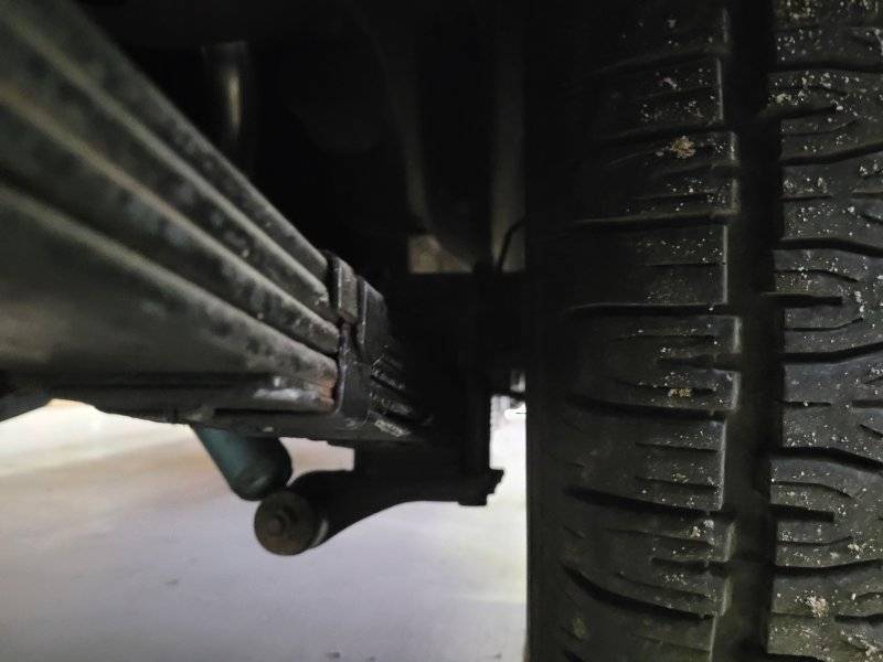

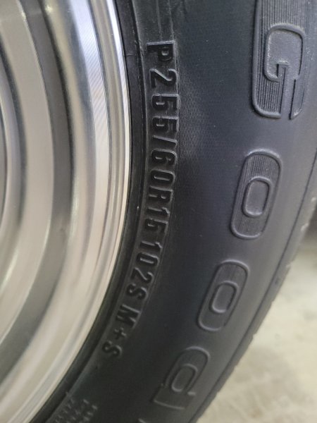

I'm running 245/60R15 on the rear. The issue with going wider is the top of the wheel wells unless you run more spring height in the rear. 255s will fit but rub. The 275/60R15 from my '64 Belvedere wouldn't fit up in there. Even my 245s have a few rub marks.

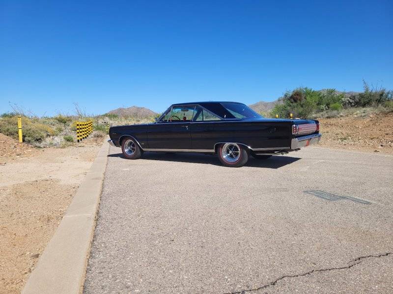

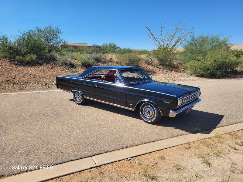

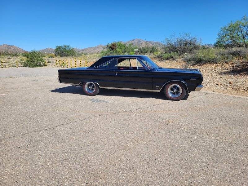

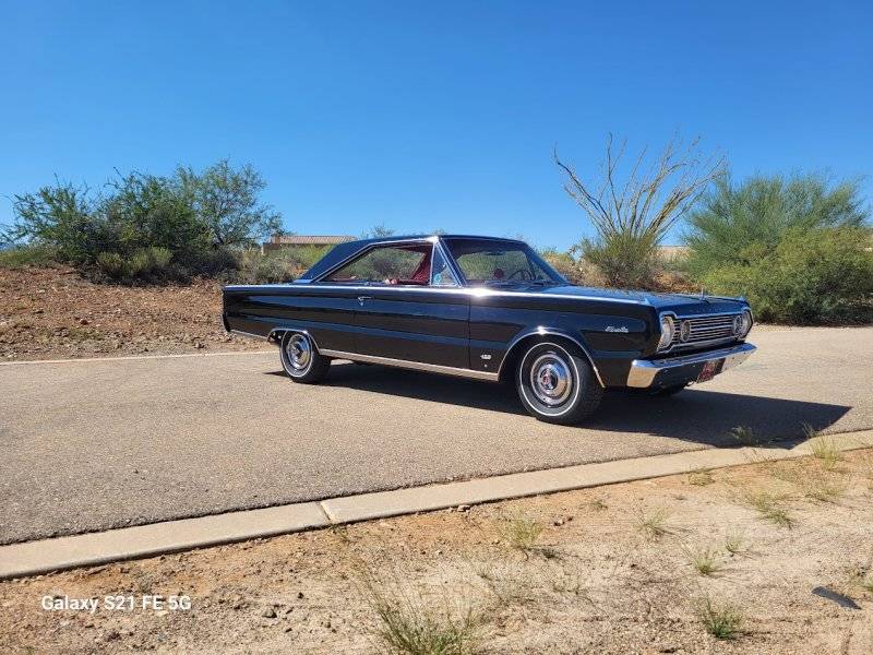

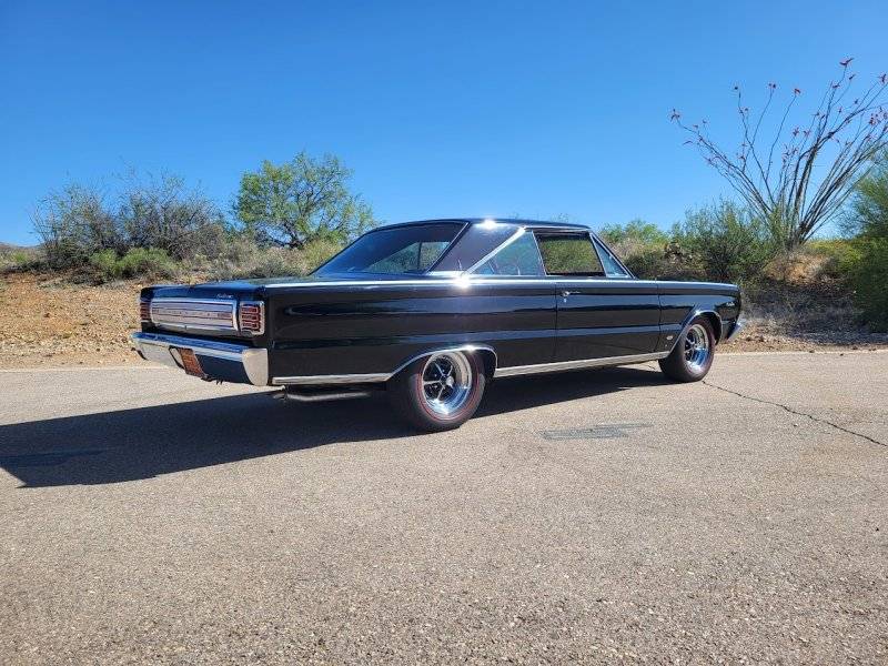

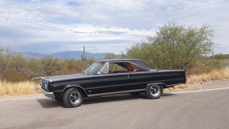

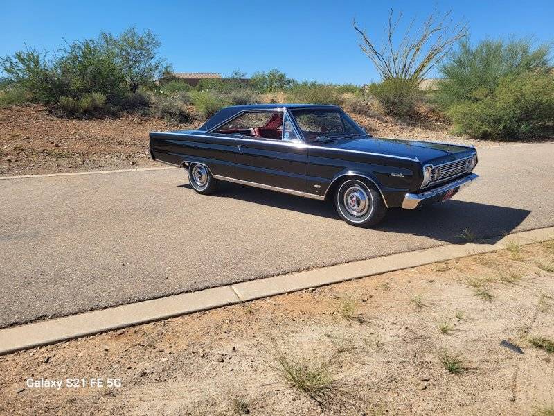

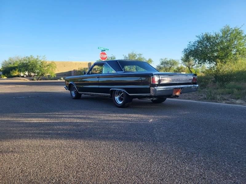

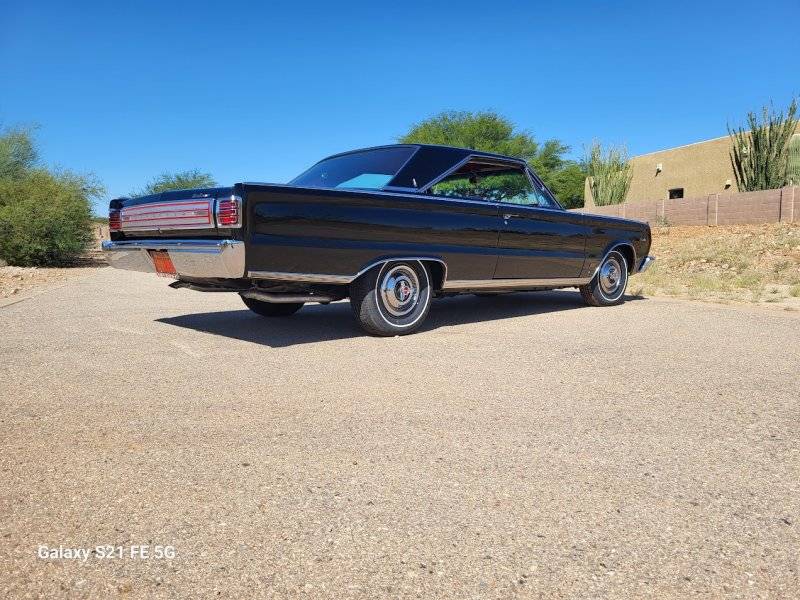

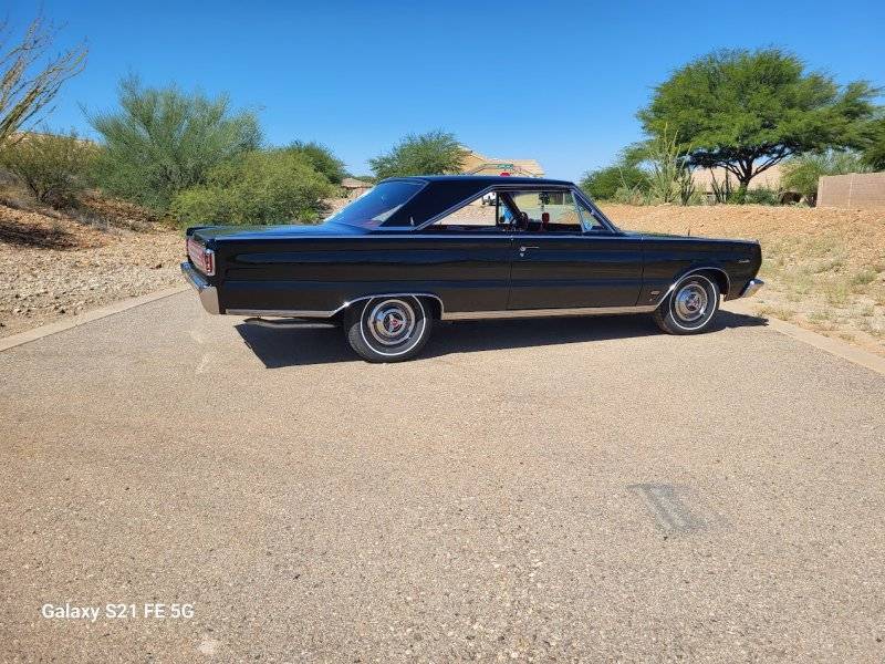

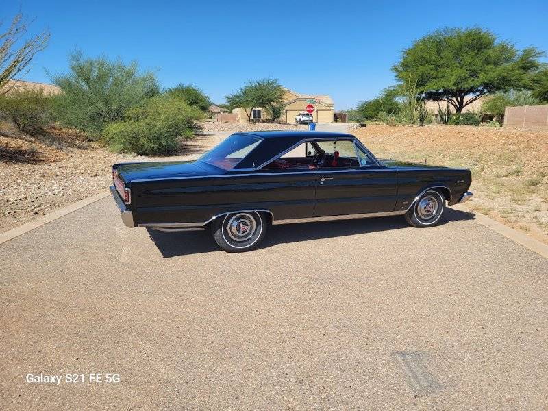

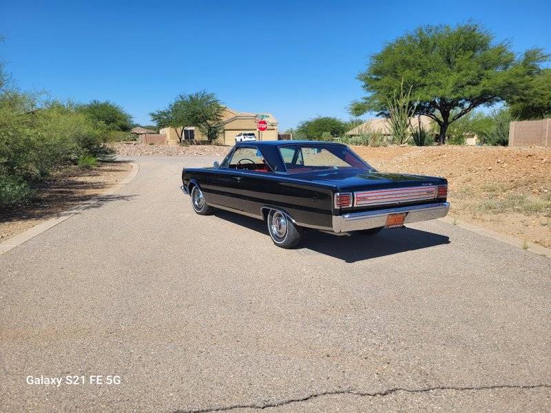

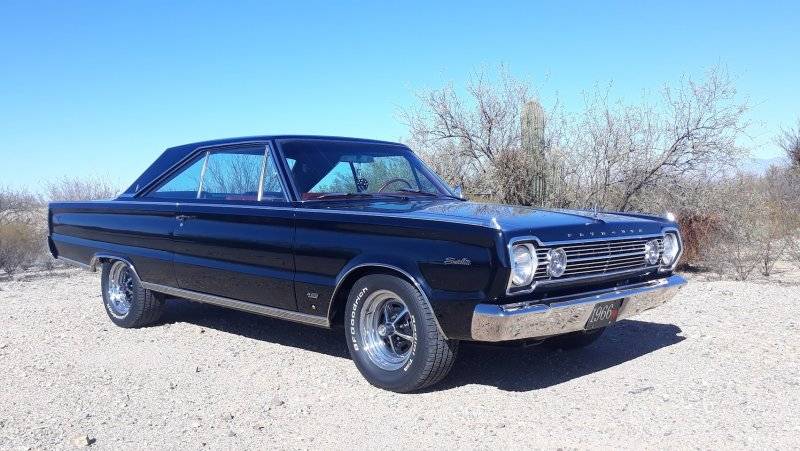

Mine has 15x7s and 245-60-15s all the way around in these pics
None of mine rub at any time - ft or rear
all stock suspension.
Not sure what the back spacing is though.
edit, I should note. in these pictures I had just installed new front spring hangers that have a second mounting point that lowers the front of the spring about an 1-1/2inch
So the wheels sit up inside the wheel lip opening just a touch as opposed to the pictures of it with RWL tires
As it sits right now
original 14 inch rims and stock wheel covers with 214-75-14 tires
