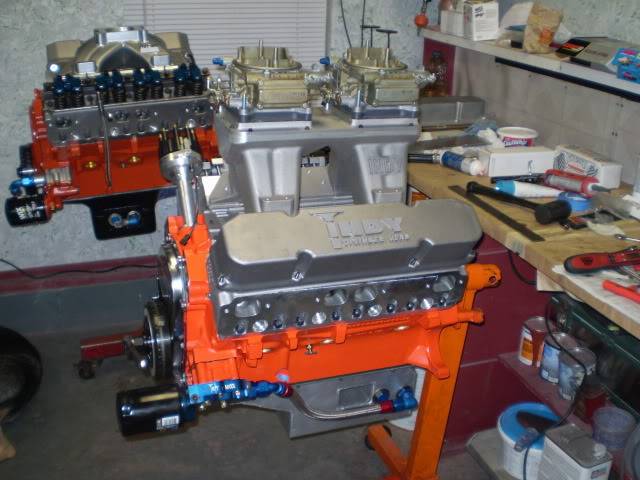

the closer one is the 400 in the car below, the far one is a 440/493 i built for my dads RR.
this is a 400/499 i built. its pretty mild really. flat tops, mild bullet roller i spec'd out. been 10.0s @ 136 with the wrong converter. should run some high 9's when he gets the converter straight. and it drives around on the street like its a warmed over 440.
