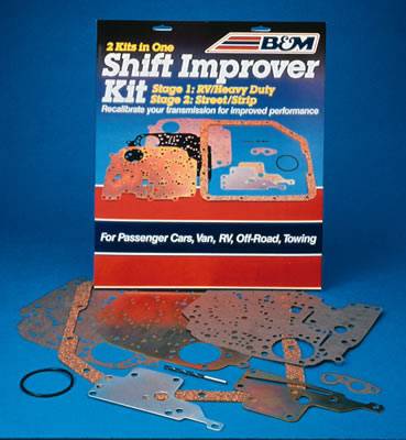

Being that I have to drop my trans pan on my A904, I want to put a shift kit in it but my question is which one.
TF-TC (62-UP) TransAction Kit (Fairbanks 10430 )
or
B&M 10225 - B&M Shift Improver Kit
Anyone used either one and what is your opinion.
any of the three are fine.. it is truly dependent upon your driving attributes and how you plan on using your vehicle. i have used all three and have not found a truly noticeable shift difference between them.
Maybe you won't notice a difference in shifts but Trans-Go includes things like a valve that you put in so fluid fills the coverter even in park (usually have to kick it in neutral for a bit with the stock valvebody if the car hasn't been run for a while and the front seal is wore.) You don't get that with the others! It's called a "no yo-yo" for some reason...
i know what it comes with.. but if you are first timer and do not want to go through all the drilling of the valve body and such and just want a firmer shift.. then the b&m is a low cost, easy install that will perform just as well as the others.
people dont buy these kits for their "pumps fluid while in park" ability.. they buy them for a firmer shift that gets them a "chirp" from 1-2. just saying.
i dont let me cars sit around long enough to worry about converter drainback :D
