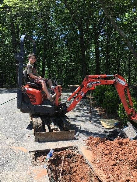

Pictures are a water leak I had to dig up. Cold patch method.
Time is quick. That backhoe operator is the current ‘68 Coronet driver.

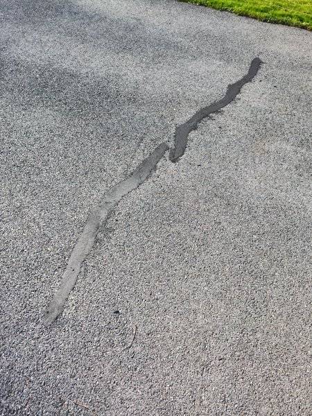

We'll see how this stuff does
Trowels in nicely, flows nicely, seems to fill well. No heat needed, looks like it sticks well. $20 a bucket at Lowe's, used 1.5 buckets on various cracks today in the sun...we shall see.
