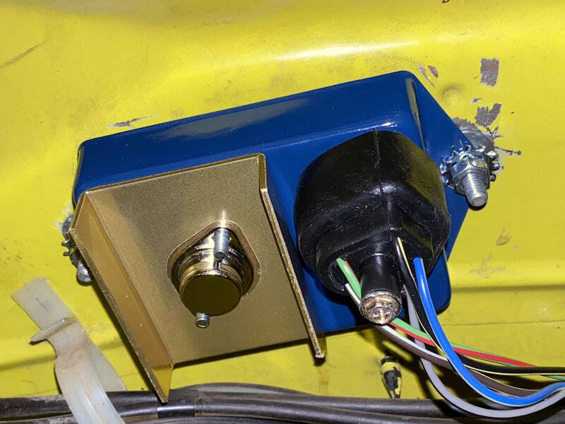

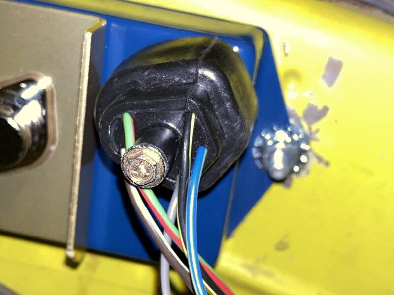

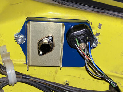

I still have the old made in China ECU that was on the car when I bought it. But I have another problem, with the Hi-Rev ECU that I never fixed after I installed it. When I installed the Hi-Rev and plugged in the wire connector, I then attempted to screw in the securing Phillips head screw that’s meant to keep the wire connector from coming off the ECU unit. That damn screw did NOT screw into the Hi-Rev box properly. And would not TIGHTEN and seat snug like it is supposed to. It just spins around as if the female threaded hole in the box is stripped. This exact screw worked fine with the made in China box and a Mopar Performance orange box. I only had problems with it on the Hi-Rev box.
So now the screw is stuck on the Hi-Rev box and I cannot get it out, therefore I cannot disconnect the wire harness from the Hi-Rev ECU box. The screw just spins in place in both directions clockwise and counterclockwise, not moving forward and not moving backward. The only thing I can think of doing is taking a hacksaw and trying to saw the head off of the screw so I can free the wire harness from the box.

If the screw turns both ways freely but doesn't bite, try pulling on it gently with the some long nose pliers while turning it counter clockwise to try to get onto the thread. Once it bites it should come out if you continue to turn it counter clockwise without pressing down, just enough to keep the screwdriver in contact with the head. If you can get something behind the end of the screw you can apply pressure that way too while turning but I'm not sure you can.

Yes, about the fastener for the screw mounted on ECU it seems to be weak and easy to spread up the thread, just like any newer China product. I bet you will be able to pull out the ECU plug just applying some force and the fastener on ECU will come out attached to the screw ( BTDT on some ECU around ).
Try to catch the screw head with plyers and get it screwed out while pulling out at the same time to check if works
Anyway I have run my Car without that screw for years, and plug never jumped out or came out loose.

If the screw turns both ways freely but doesn't bite, try pulling on it gently with the some long nose pliers while turning it counter clockwise to try to get onto the thread........
Email Richard E. and let him know about that stripped screw. He's always been good to me for answering quickly. If all else fails and you need to get that screw out, just drill the head off of it.

I think the vice grip idea will work.
Otherwise try some plastic wedges and slide a narrow one beneath the molded plug and push the plug off while backing off the screw.

I had similar stripped screw on mine, I have a prong tool I use for removing door panels that comes in handy for a lot of other things, if you have one slip it behind the screw head creating outward pressure while turning the screw CC. A small needle nose pliers should work as well or slip in a flat blade screwdriver. As for crank and no start you're ECU requires a good ground...sure you're aware; but tossing it out: Check for spark at a plug wire and see if that's the demon, check your connections, coil, etc. also with all the cranking if you can't detect any gas odor that's a signal..
