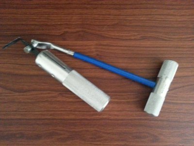

Using a piano wire or guitar wire is the recommended method to slice through the old mastic sealer, and its easier to do when the weather is hot, even the old stuff will soften up a bit on a good hot day. Be careful on the rear glass as one false move or too much stress on the window and it will be toast since its tempered safety glass. I used a utility knife on the inside to cut through and used this tool on the outside to cut through. And as conv67bdere says, the windshield, work around it to get one edge loose. For the back glass, you can do the same approach, however, be careful once again as too much stress and it will shatter.

It is best to remove as much of the gasket or sealant with a utility knife, then use the tool pictured above. it's only like $15 at amazon.

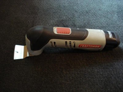

I have also had good results using a craftsman ossilating cutter to slice sealant the windshield tool couldn't reachcraftsman-cutter.jpg

IMO, If this is your first time "please don't use the tool shown"!
These things have been the cause of more broken/cracked windshields (front and back)than any one thing on the planet. Especially if your inexperienced.
I cant disagree with you there, so I experimented with it on my windshield first, as it was already cracked, it is a bit tricky, and actually works better with the t-handle removed, and you can then slowly work it along the window without putting any pressure on the glass. After seeing how it worked it was great to use on my back glass which was successfully removed.
