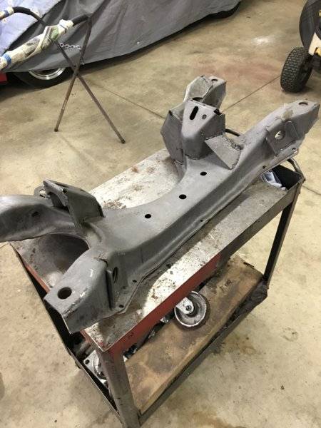

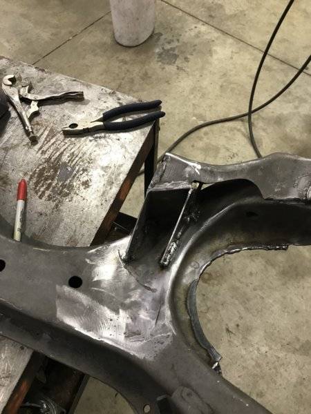

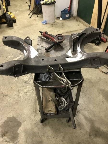

Got a small block k member. Cut the mounts off and am doing some reinforcement work. Still welding on it.

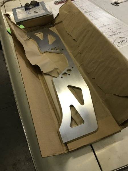

And my new motor plate
Just went through this whole thread for the first time. Patience is a virtue that doesn’t come easy to me, so I commend you on keeping your momentum. Keep inching along and keeping us posted. :thumbsup:

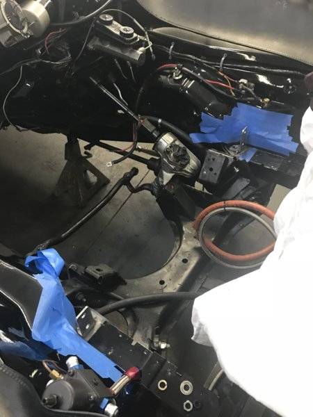

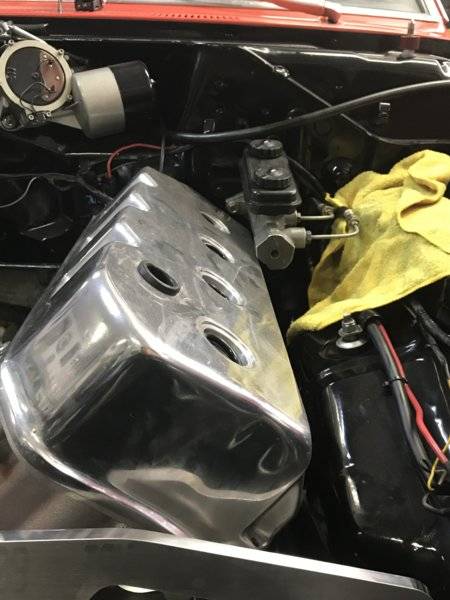

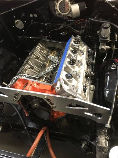

Doing a little mock up, may go to tti headers so I wanted to see how the master cylinder clearance looked if I change the engine positioning slightly.
Plenty of room
11 lbs of stuff, stuffed in a 9 lb package :thumbsup:
Well I’m going to assume their will be no more 4 speed in the dart lol. 4 speed and that big of an arm massive torque equals massively exspensive carnage lol

Motor plate brackets are tacked, I’ll weld them up while the kframe is out.

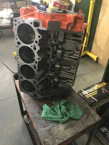

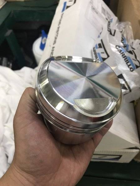

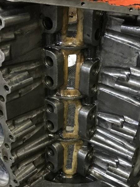

My epoxy was just beginning to come loose. Decided I “shouldn’t” need it anyway so broke all that out and cleaned it up. It was still stuck better than I though. Cleaned up all my gasket sufrfaces. Just need to bolt up the caps and have the new pistons fit. I only went 0.005 because the bores were still real nice. Thank you air cleaners!
Looking good!
Progress...
I'd cut that K frame so the oil pan can come off. You will thank me later.
