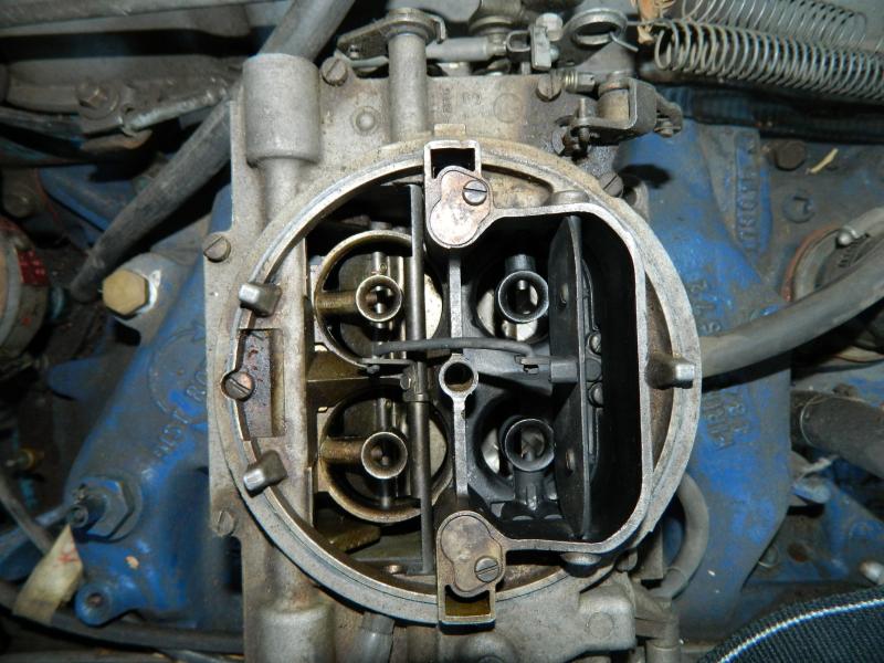

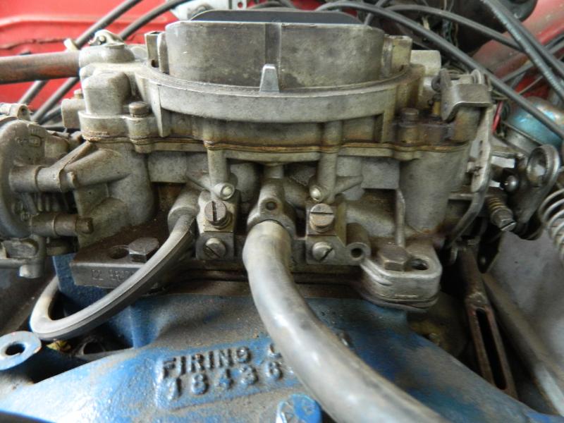

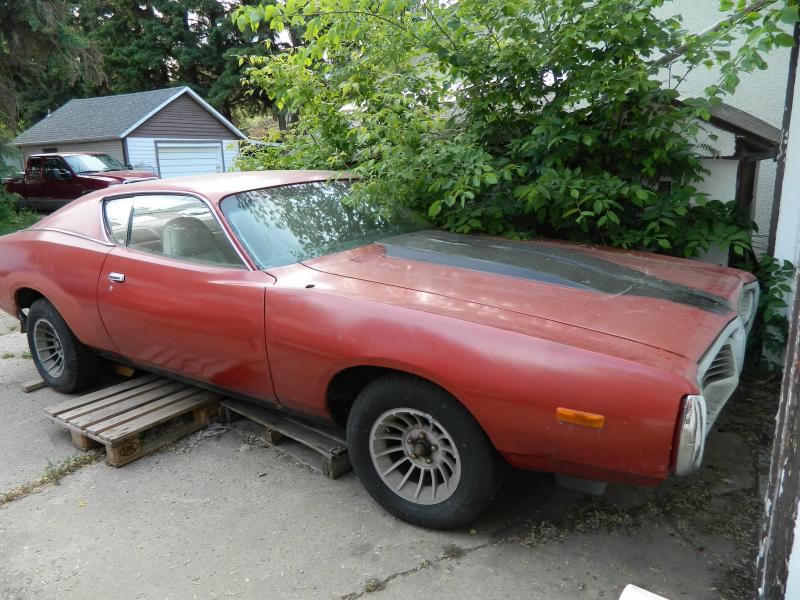

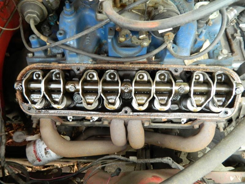

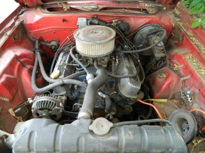

I have a 72 charger with a stock 318 but not matching numbers, and have the chance to buy a 400 with 727 trans running as I speak for 1000 OBO and is from a 73 newport. So should I go for the change and what should be the most I should pay for it. Plus is there that much difference I will notice. Thanks
