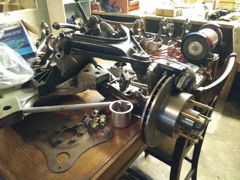

It doesn’t slide up/down. I’m having trouble trying to explain how it works. To me, your bushing doesn’t seem as though it’s pressed together all the way.
What year is your car?
67
It goes on just like a tie rod end or ball joint with the tapered shaft and castle nut with cotter pin.
Have the back end on the ground and lowered the front down to ride height.

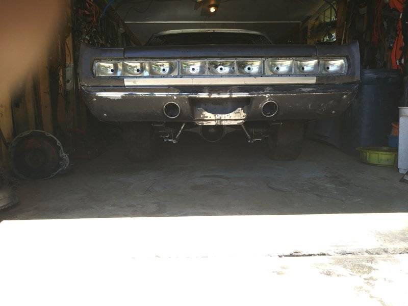

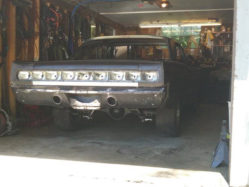

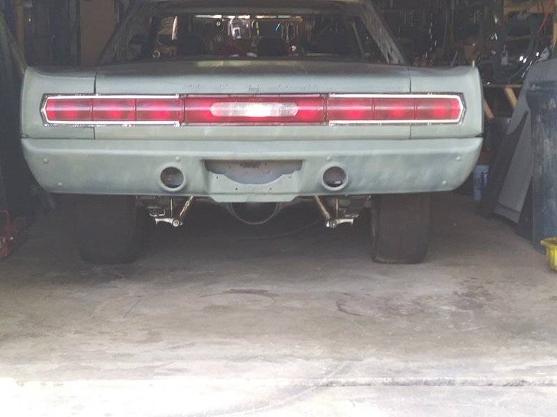

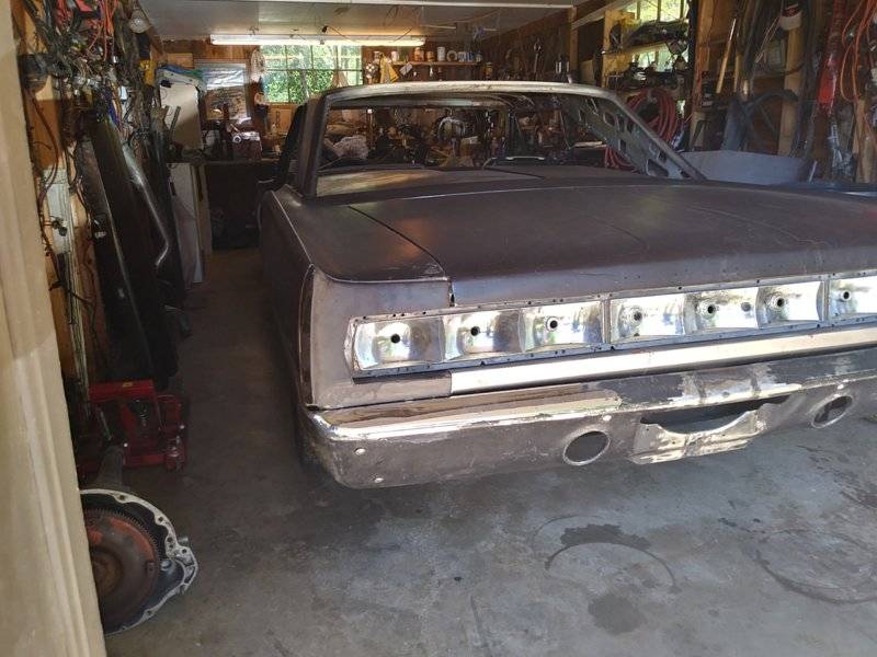

So, a fella shows up today to buy the truck seat. I pushed the garage remote and when the door went up he and his 15 yar old son both said, " Holy cow! What IS that?" Talking about the Express. lol. They drooled all over it. Wanted the whole story. They were very impressed. He said, about the rear lights and bumper, " Man, THAT is pure genius. Very cool." They were totally floored. He is the president of a car chapter that mainly deals with old Chevy's from the 50's. He owns several 55/56/57's. His son though....lol...I think he's a convert to MOPAR now. He went to the fence to see the donkeys and his Dad told me that he has never seen that much of a reaction from him about any car.

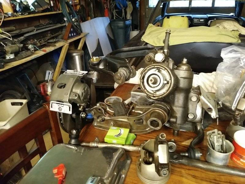

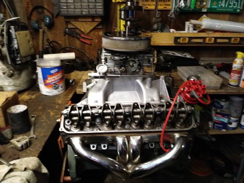

I like what I see. Just not to sure if those block huggers are gonna fit.
They don't. They both rub against the block and I doubt they will clear once it's in place.

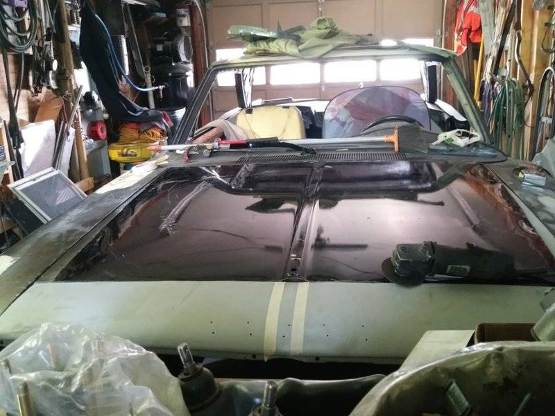

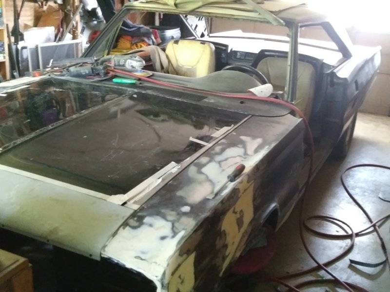

So, I had a bright idea for the hood. I was staring at the truck hood and wondering what to do with it since it wont sell. I then got out the tape measure and checked it for size. Yup, will fit with a little cutting down. So I separated the skin from frame and trimmed the curved down edges and front edge so it will lay fairly flat on the 67 frame. After some positioning and trimming I have it centered and cut to fit. Next is slicing the 67 skin out of the way and after placing 3M foaming adhesive in between the skin and 67 frame and letting it dry, I will weld it up and apply filler as needed to smooth out the welds. Plan to place a hemi scoop over that center spine.
I will have to form a nose piece to continue the spine onto the front 8 inch section and close it out as it goes forward. The panels have a built in curve across from left to right and the foam will cushion that curvature and keep it smooth, right now there's a 1/2 inch gap between the hood frame and the new skin in the middle. Cutting it into the original skin will lower that to 3/8ths or less, just right. The outer edges are closer as you go from the center out.
