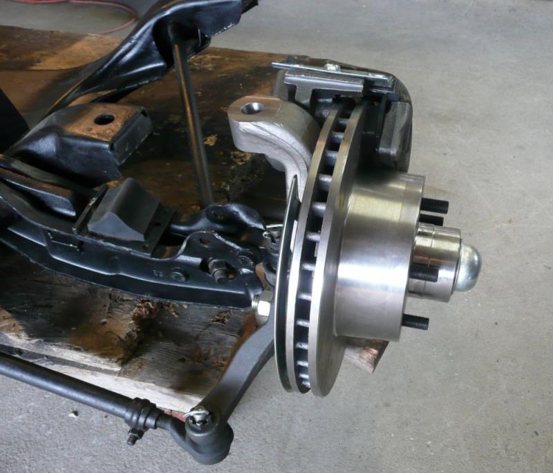

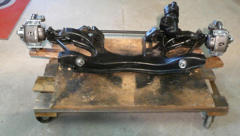

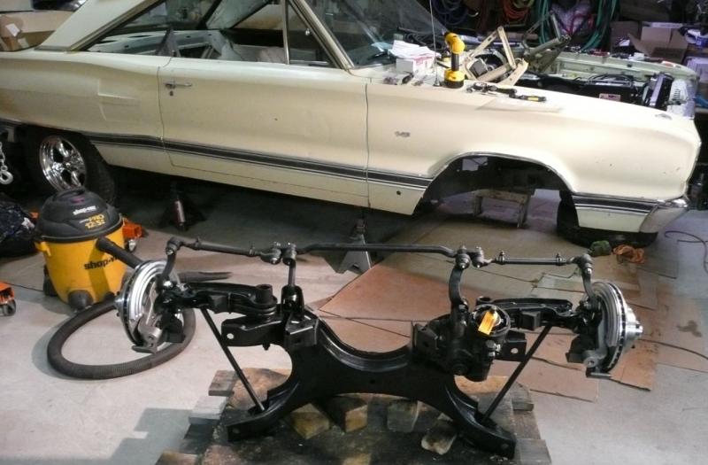

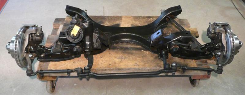

I got some disc brakes installed on the K member today, moving along on this build.
You're the man MT, you're the man.
Was pulling that K member out a PITA? How long did it take? The more I look at mine the more I think I need to pull it.
The K member is not bad at all, I guess it depends on time, If I were in a hurry or on a schedule then something would go wrong or get stuck and I would be pissed.
I just took my time and checked with the forum and the service manual, mainly about the torsion bars and upper control arms.
There is quite a bit to replace on these, I used PST kit for ball joints, control arms, bushings and steering. That power steering pump was leaking like a POS, I was glad that was only $160 to replace.

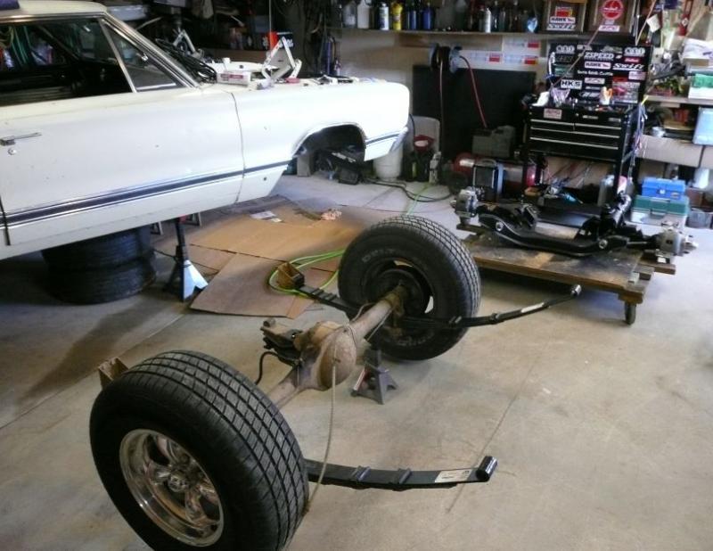

I have been seriously contemplating installing the new motor on the K member and then lowering the car down on that. The only problem I see is lowering the car down, I can easily get the motor on the K member, and get the front of the car up high enough with jacks, but lowering has me stuck. I don't have anything overhead so I am forced to do everything from underneath, I could weld up some type of frame... not quite sure on this one. Any suggestions on how to do that would help.
I'm think I am going to just go back with installing the old conventional puller/picker method.
Going to install the brake calipers today and dink around with a few more wire jobs.

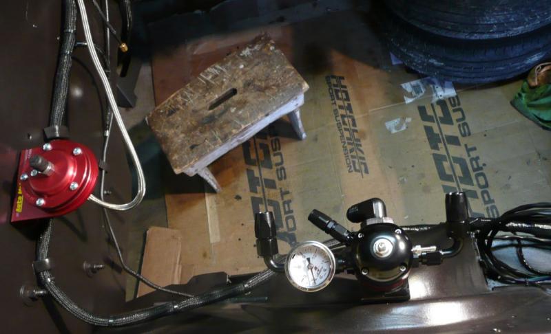

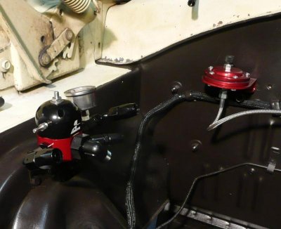

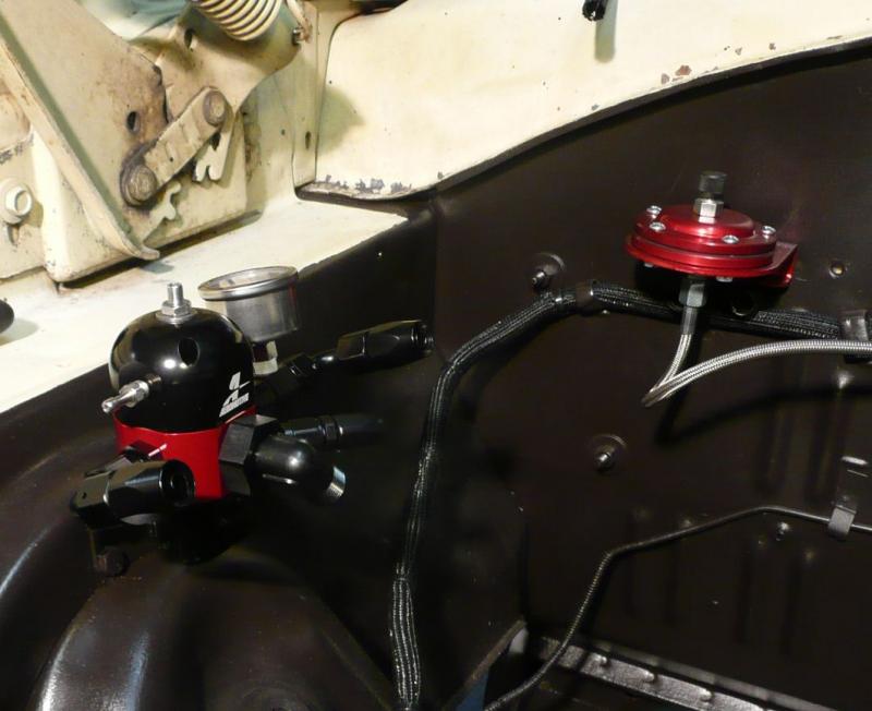

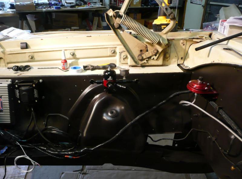

I also installed my fuel pressure regulator and getting ready to run my fuel lines from the back of the car.
It seemed like there was a ton to replace. My bushings are pretty much toast.
That's a pretty good idea lowering the car onto the motor. I'm sure someone on here has a good way to do it.

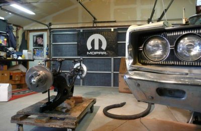

Got a new garage banner installed, makes the place a little more livable.

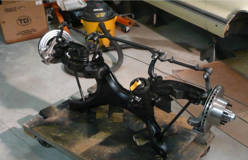

Also finished up the caliper install. Should install the K member soon.
Looking good! That fully assembled K frame makes me regret not going that route on mine.

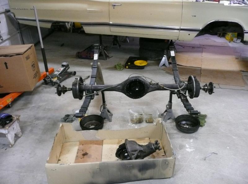

Time for some 8 3/4 work, nothing more embarrassing than leaving one black stripe on the pavement!

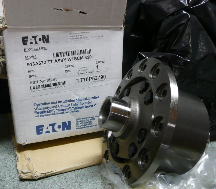

I got an Eaton locker to install, that will be fun.

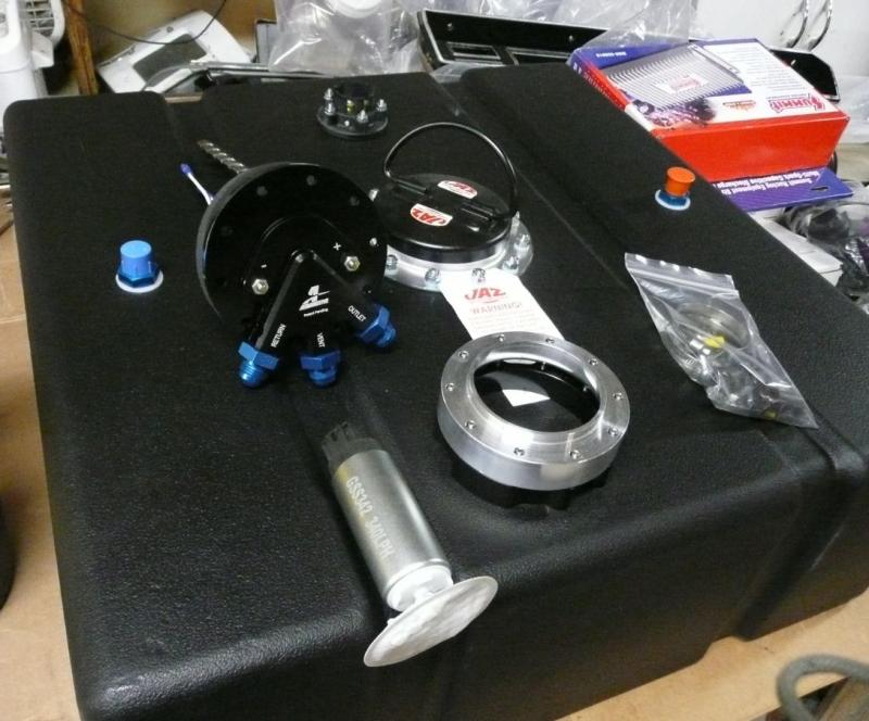

Installing a 340LPH fuel system into a 22 gal. fuel cell.
The 8 3/4 center section is going to my gear man tomorrow, he is installing the locker with a 3:73.1 ring and pinion.
