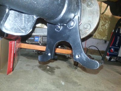

Well I got out in the garage last night and finished the brake brackets. Now will finish painting the rearend, brackets, and then re-assemble for teh last time before spring rolls around. I can't wait to get this thing in the car!. Brakes turned out really nice, I might add a bit of reinforcement to the pad supports and I'll probably weld the bolt heads to the bracket like studs for strength.
If anybody is interested in these brakes please respond to my other thread about brakes in the general discussion forum. If I get 5 people wanting a set I will fabricate 5 sets and sell them but individual sets are cost prohibitive with having them custom cut and then my time to make sure it all fits, tapping the holes etc.

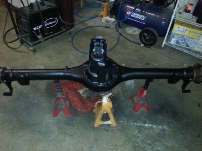

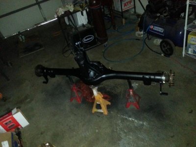

Just a touch more progress from this weekend. I managed to paint the axle, brackets etc and re-assemble the rear end with the new wheel bearings etc. I still plan to paint the bearing flanges (haven't done it yet) but that's next now that its assembled and I can get to them easier. Now if only that diff was a suregrip!

Rearend looks good. Did you make the mounts for the calipers yourself? great work.
Yup, made them myself. I do have a thread in the general forum called 8 3/4 disk brakes

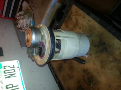

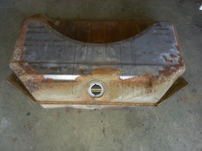

Well I did some cutting and fitting on the gas tank and its looking like I may have to do a different thing. My in tank pump is tooo tall though I may take it apart and see if I can make it shorter. If I can make it shorter then ill make a small sump and recess the top down a bit.
---Edit----
I took a few more measurements and I think for the sake of saving money I will just make the sump. It will have to be 3" deeper and might look a little silly but it will be functional and help with fuel starvation since the sump will hold gas even during cornering. If I make this and it doesn't work I'll start surfing Craigslist for fuel cell's since I'd rather run one of those then a stock tank and external pump.

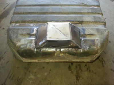

Ok, well i finally got back at it today. I ran out of welding gas but got the bottom sump attached and mostly welded in minus a few leaks i need to seal weld. But its close. So ill weld the inside seam after i get more gas next week and then work on the top after i get more steel.

Hey, your car has it's own bulge now, cool! :toothy5:
Looks like it should work fine and it's in the front of the tank near the axle so I doubt it will be noticed. Just in case, you could always slap a HEMI badge on the rear face :icon_bounce:
