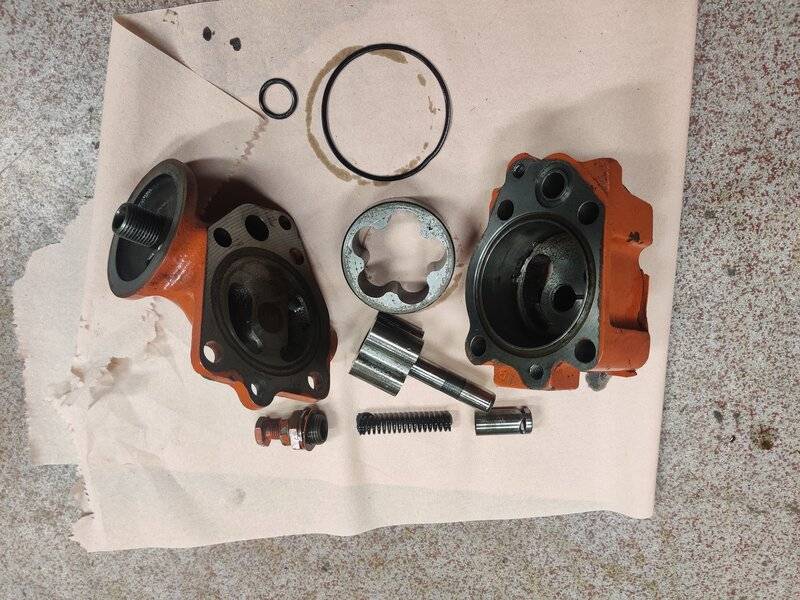

Cavitation in the oil pump or a sticking relief valve could be the culprit since the engine has been sitting for 4 years.
Managed to dismantle the pump in it's location(it's tight around a hemi with headers!!) and twist it out and inspect the internals. Everything looked good unfortunately. Sourced new o-rings locally that seemed to fit, everything was really worn and I doubted it would seal properly again.
There are many opinions out there but I decided to grease everything up with lithium grease that will desolve after warm up. This is for helping the pump to get proper suction.
Fit everything again, mounted the drill, ran it ccw and laugh and behold, I could feel the pump grabbing after a turn or two, almost yanked the drill out of my hand!!
I was so confident that I would see pressure but I was totally devastated when I yet again saw zero pressure at the mechanical gauge.. what could be wrong? Could the right oil gallery be clogged, oil filter clogged?
Removed the filter, ran the drill slightly and oil flushed out! So the pump is priming and flowing but I'm not getting pressure.. could it be a open galley plug or broken rocker making it an internal leak? Hope not because it's a pain removing the valve covers to inspect.

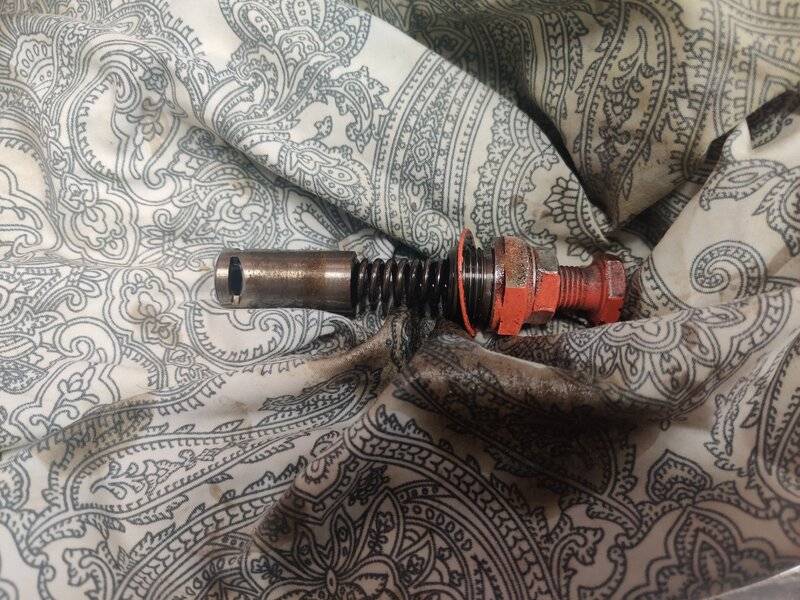

I was running out of ideas but I tried filling the right galley through the hose I connected but I couldn't? So I removed the fitting and it looked fine.. screw it in again and fitted the hose. Adjusted the relief valve to increase pressure and ran the drill again. BAM!!! Oil everywhere...
The hose had popped lose. What the hell was this...
Took everything apart again and inspected it, tried blowing through the rubber hose.... Completely sealed... Used compressed air on it and bang! Out shoots a screw!!? The hose was sealed with a damn screw!? I was both happy and sad at the same time.. imagine your wife telling you that, out of your friends, you have the biggest dick of them all. That's how I felt.
Put everything together again, ran the drill ccw, felt it grab oil and heureka, we have oil pressure!

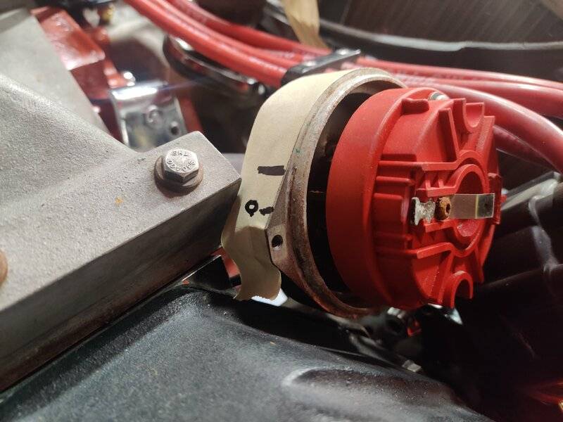

Checked that rotor was pointing at no1 cylinder at tdc in case I got something wrong when removing and replacing the timing gear and oilpump drive but it seemed correct. When turning the engine by hand I measured and found that rotor was pointing at no1 plug wire at approximately 15deg before tdc on cylinder 1. Seems correct?
Started it again, checked with strobe and I"m att 15deg on idle, 950rpm. Still intermittent pops. Checked the lambda and AFR seems on the highside even though I had black plugs?

Looking at the last picture of your distributor there's a lot of corrosion and rust on the rotor. That's a sign of moisture. Does the inside of the cap have corrosion? What's the pickup look like? This could be your popping.
The last time I had a popping like in your videos my new plug wires were slipping away from the plug. It was just a small gap but that's all it took.
Yes, you are correct, there is a lot of corrosion and I'll have to replace it but I was planning to do that when it's time for the efi conversion. It looked like this when it was in the previous car also and we didn't have the popping then. I'm going to check CO when I get home again. Away on a business trip to Netherlands this week..

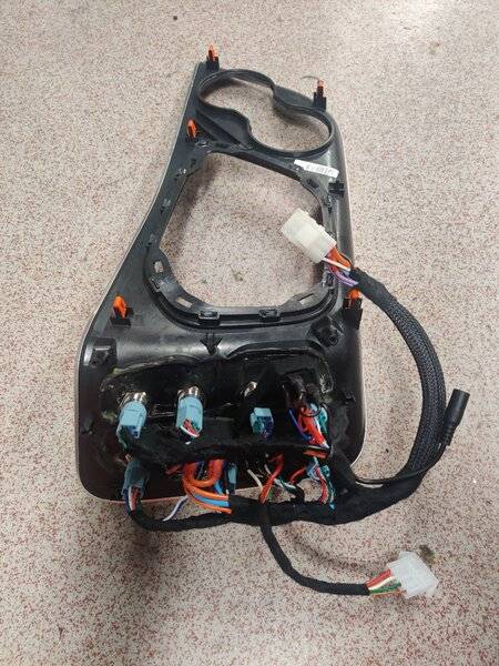

Chaos and Mayhem but almost completed. Looms with connectors are done, wiring diagrams completed, just need to wire up the buttons.
Everything is connected with quick connectors so it's easy to remove all panels without cutting.

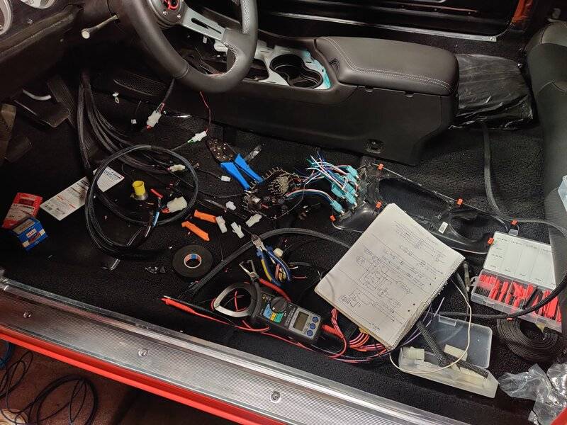

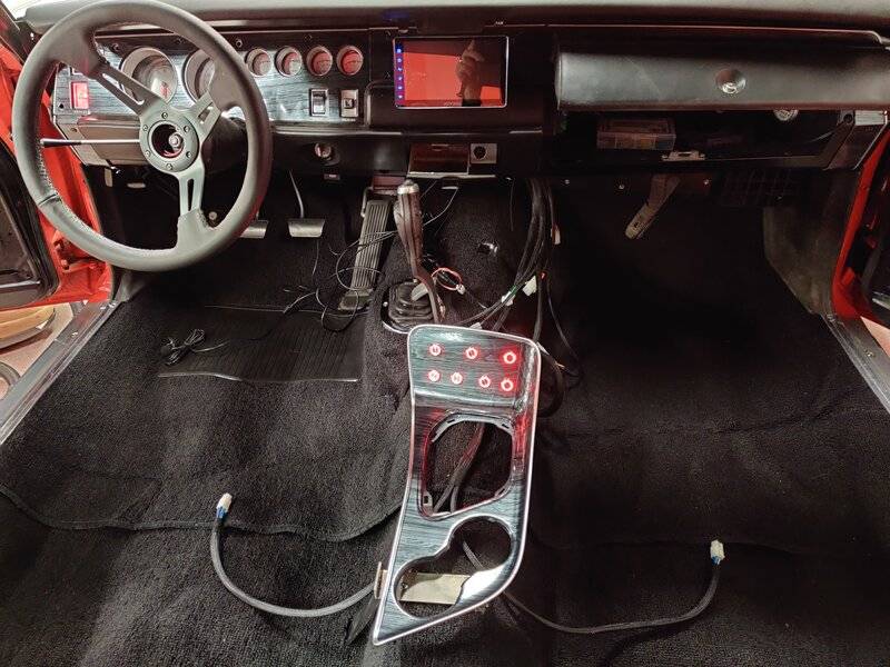

After some trial and error, headache and some burnt fuses the wiring is now completed.
I wanted to have the buttons change color when activated and the hazard button to flash with the turn signals. Everything laid out so it's time to fit the seats and maybe take it out for a short drive.

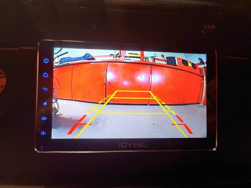

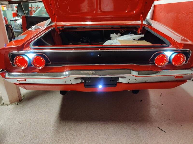

Connected and tried out the backup lights and rear view camera and it actually worked on the first try.

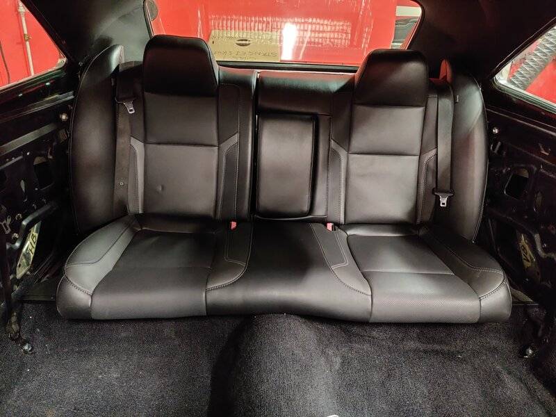

Fitted the rear seat also.. bits and pieces.

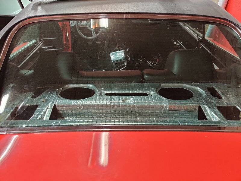

I have received all the stuff I need for the interior Door and rear panels so I'll start working on that now. Audio system installation can also be started, just need to figure out the layout. I'm not happy with it yet.
